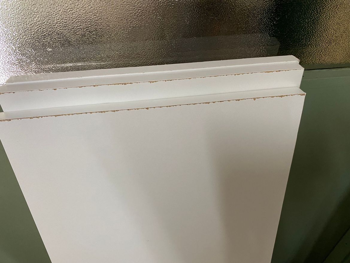

I bought recently from Bunnings 6 ,1200 * 300 melamine coated panels. Every panel is damaged from saw cuts on each end which has left a series of small chips. One side and both ends are not covered with Melamine. I have glued on the provided melamine strips covering all raw faces.
The attached photo shows one end of a board. I could not buy the appropriate touch up paint suggested by the lady at the tradesman's counter as you were out of stock. I have purchased from Lincoln Sentry a Melamine white touch up paint and my question is, how best to apply the product. Do I dab it on or try and run a single line of paint along the edge. Will it look like a patched up job no matter what I do and am I better off just leaving it as it is.?

The common method of repair is to dab the touch up paint on the damaged areas only. Your goal is to visually reduce the number of chips you can see on the edge of the melamine. A bit of patience will be required when applying the touch up paint, but the results will be worth it.
Applying it in a straight line will make it more noticeable as the paint has bit of depth to it when applied to a flat surface.
I suggest sending your photos to this email address - workshop@bunnings.com.au and we'll post them for you.

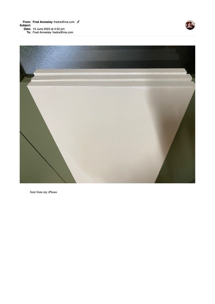

You will see that I managed to get a photo of the boards as I bought them plus my tape of the raw edges

finished touchup panels
Hello @Fred4
Thank you so much for posting that update, those shelves look much better now that you've applied the touch up paint. Would it be possible for you to post where the shelves will be positioned? I'm sure our members would be keen to see the overall picture of your project.
