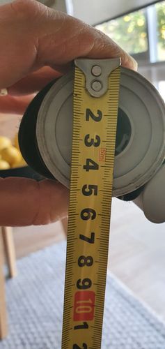

Hi my roller blind cord has broken. Additionally the roller blind no longer stays up. I need to replace the mechanism and cord. However I'm not sure on the size I need. The mechanism measures 53mm in diameter on the external side. Is this the correct place to measure and any ideas where I can order the mechanism and cord? (it needs to be fairly long as these are large windows and I'd prefer a metal cord)

Thanks Brad. The problem I have is the stub measures 53mm in diameter. I've yet to find that size online or in store.

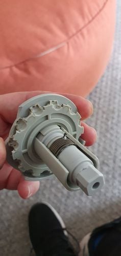

Hello @DanManc
It's great that you've received fantastic advice from @Brad. Would it be possible for you to post a photo of the end of the blind? If you can post the end size of the pipe that is holding your roller blind, I can ask our provider if they have anything that will fit your pipe. Can I also please ask you to measure the interior stub of the blind holder as I've indicated in the picture below? Once I have this information, I will be able to ask our provider for possible spare parts.
Please keep us updated.

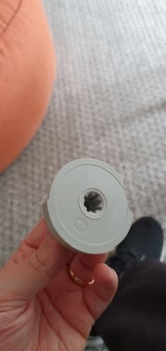

Hi Eric the stub measures 20mm across. Likewise the hole at the entry of the blind itself as pictured. The blind entry itself is 53mm in diameter.
Hello @DanManc
Thank you so much for posting the updated photos on those blinds. I've spoken to our provider and I'm so sorry but I've been informed that there is no compatible size for that roller blind in their set. However, I suggest considering the option of replacing the entire assembly. Can the plastic assembly be removed from the pipe or is it part of the entire blind? If it can be removed you will then see the true size of the pipe. The other option is to bring your assembly with you and match it with spares from dedicated roller blind shops. If you need further assistance, please let us know.
