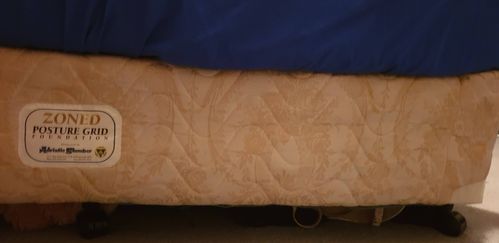

Hello @Connie101
Thank you for posting a picture of your headboard. This would make an excellent addition to your beds set-up. Would it be possible for you to post a few photos of your bed frame with the mattress taken off? This will let us know if your bed frame is made of timber or steel. Can you also please find out if your headboard came with any instructions or recommendations when drilling into it. The last thing we want to do is to drill into the wrong area of your headboard.

Hi Eric,
Thank you for your advice. I've managed to take a photo of the bed base. It's an ensemble, not a bed frame. The headboard didn't come with instructions as it's a free-standing one-piece headboard without any mounting holes or feet. It didn't occur to me that the headboard wouldn't stand on its own and needed to be firmly secured somehow. Either attach it to the ensemble base or maybe install feet underneath to hold it firmly onto the floor.

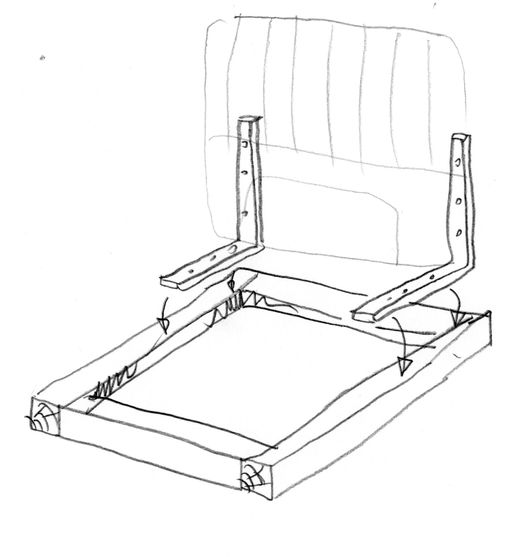

Hi @Connie101
We're making progress here, now that we know we can't anchor the headboard to your bed, we need to find out the actual width of your bed. The reason being, if the headboard is larger than your bed, legs can be installed at the side of it preventing it from tipping over.
I've drawn up a basic diagram to give you an idea of how it can be done. The closest measurement for your headboard is a double bed. That is the example that I used for the sketch. Please let me know what you think. It is possible to be more creative with the feet, you can turn them into small nightstands on the condition that you have the space for it.
Thank you very much for your reply. A top idea! I love the sketches as it gives me a clear visual of what can be done. EXCELLENT!!

Amateurish thought - but a wooden frame with large brackets attached. This will fit under the bed and nothing should be seen. The headboard fits between the brackets and held there when you push the bed back - or a few screws to the back of the vertical brackets.
Just a Saturday arvo thought. 🙂
Thought No.2. 😏
Possibly the vertical part of the bracket won't be long enough? (Bunnings' largest is 235mm?)

Hi @Noyade,
I really appreciate your Saturday arvo idea, and thank you so much for providing the diagram. It has given me a clear visual representation of where exactly to install the frame. I've considered the brackets, but wondering about the best way to attach them to both the headboard and the frame itself. This sounds like a good plan; I'll try it!
