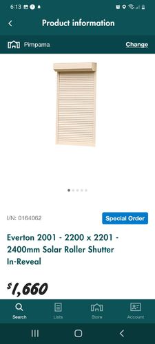

I am not sure how roller shutters compare to double glasing pricing but I have had electric roller shutters on a previous house when I was doing night shifts full-time and they were fantastic for keeping out light and sound. It's another option to consider anyways.
Carl
 There are a few options hop on the app and search roller shutter.
