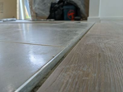

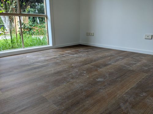

I recently did my first attempt at laying hybrid flooring (replaced the existing carpets) on the concrete floor, in my small living room.
I plan on adding scotia (deciding between white and matching the flooring) to the skirting, but before I do that - I'd like to get the transition sorted. At this point, the gap of the transition is about 10mm and the edge of the tiles appear to maybe 3mm higher than the hybrid flooring. Is there a nice simple solution here?
I don't want a transition that's too wide (for my liking haha), and ideally I'd prefer if i didn't have to have a larger gap for any transition "base" (which may require screwing into the concrete?). Honestly, if I have to just use some concrete glue or something I would do it. Some examples of what I was looking at: https://postimg.cc/LYHQXHR6
I also like the existing metal on the title edge, would love to somehow transition that smoothly, but would love to see what my options are and all suggestions welcome. It's my first time with transition stuff, so there are a lot of considerations I'm probably missing.

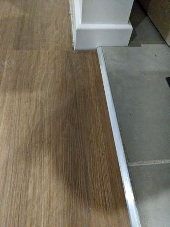

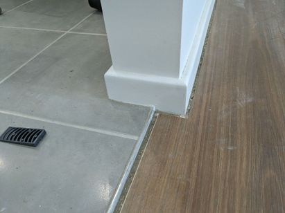

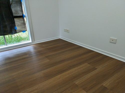

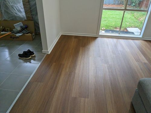

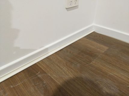

Hey all, an update for this thread.
@TedBear, I took your concern into consideration and I also did notice that some bits it only JUST fit the width, so I ended up opting for a wider transition strip. It was the wider version of the QEP transition cover trim that @MitchellMc had suggested. I was a bit worried at first it would be make movement as you walked over it, but after a day of it being held down with the construction adhesive, it's 100% not moving and it feels safe to walk over.
@EricL, thank you for the advice. I ended up using this primer and then the leftover Dulux white-on-white paint I had to get it matching the skirting. Used compound mitre saw + brad nailer (ryobi 18V) + caulking with https://www.bunnings.com.au/selleys-475g-no-more-gaps-interior-multipurpose-gap-filler_p1230010 (with painters tape for a nicer finish) for the first time! I'd say overall it was a success.
Once again, thanks to everyone for all your great advice. I'll be sure to come back to this forum for more in the future ![]()
Here are some pictures:
