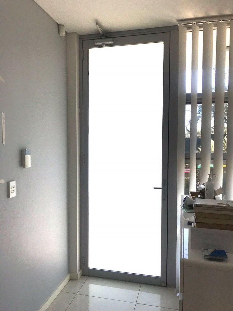

My entrance door is glazed single leaf type, size 950 x 2600mm high (it's rather tall and heavy).
Please see photos.

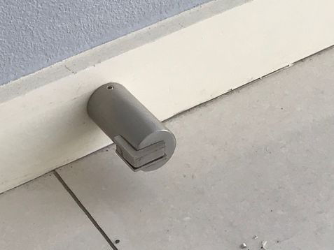

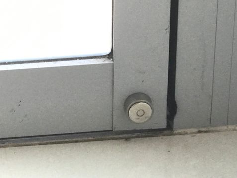

We installed a magnetic door stop two months ago, but it was too weak.
Sometimes i need to hold the door for some seconds until it was attached, and therefore i want to change another one.
In this regard, do you think Delf is strong enough for me ?
Thx.
Thank you for posting pictures of your door. Your automatic door closer is pulling it off the magnetic door holder. It is a bit of a balancing act, the adjustment has to be exactly strong enough to close the door, but light enough that the magnetic door holder will hold it in place. Your other option is to attach another magnetic door holder to compensate for the door closer. If you need further assistance, please let us know.
If the door fitting was hollow I would add rare earth magnets till the grip was where you are happy with it.
