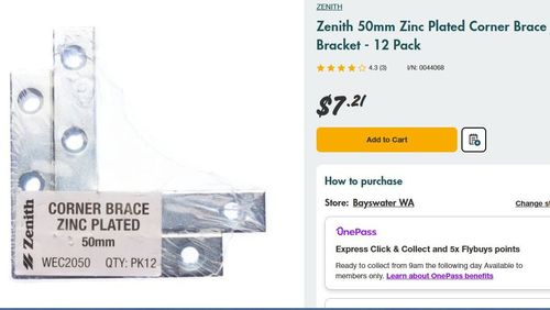

You can butt glue the timber joints and use corner brace brackets with optional mortice/tenon fit.

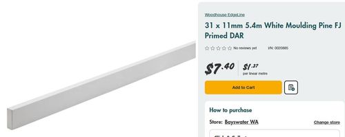

You may have to nail on 'adaptor strips' to suit the sliding door recess.
Dressed pine.

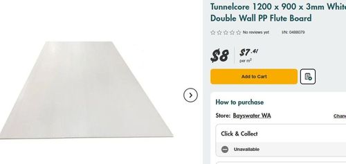

Flute board.
