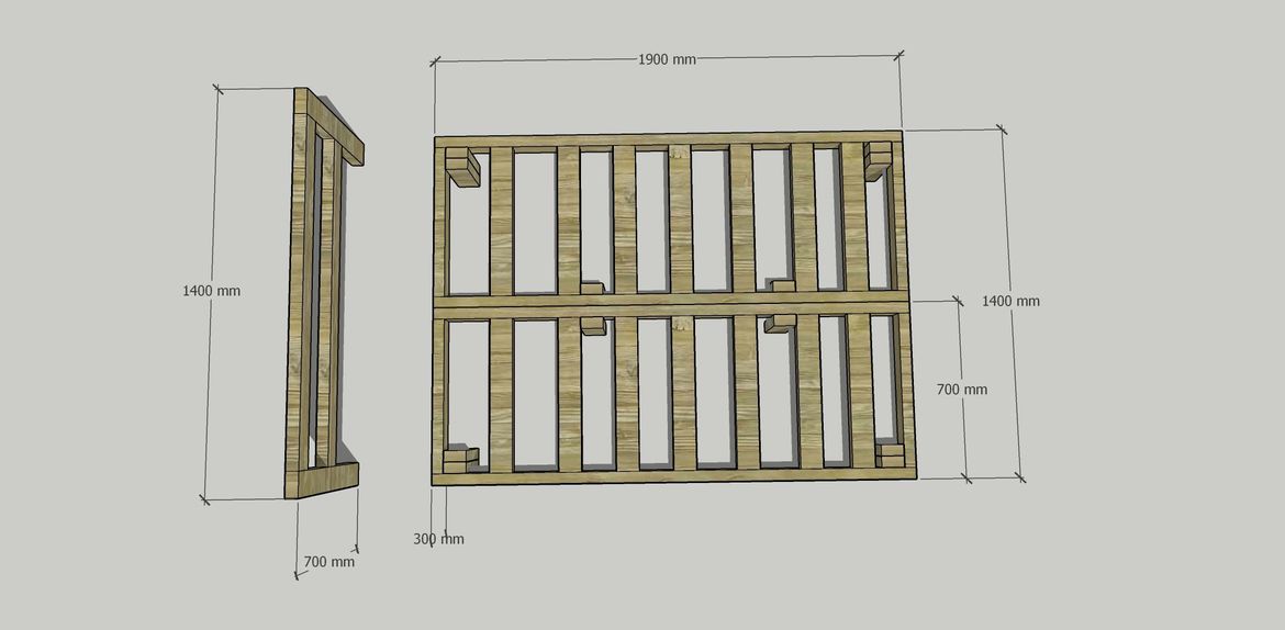

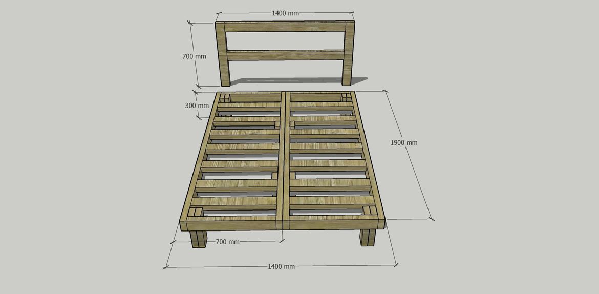

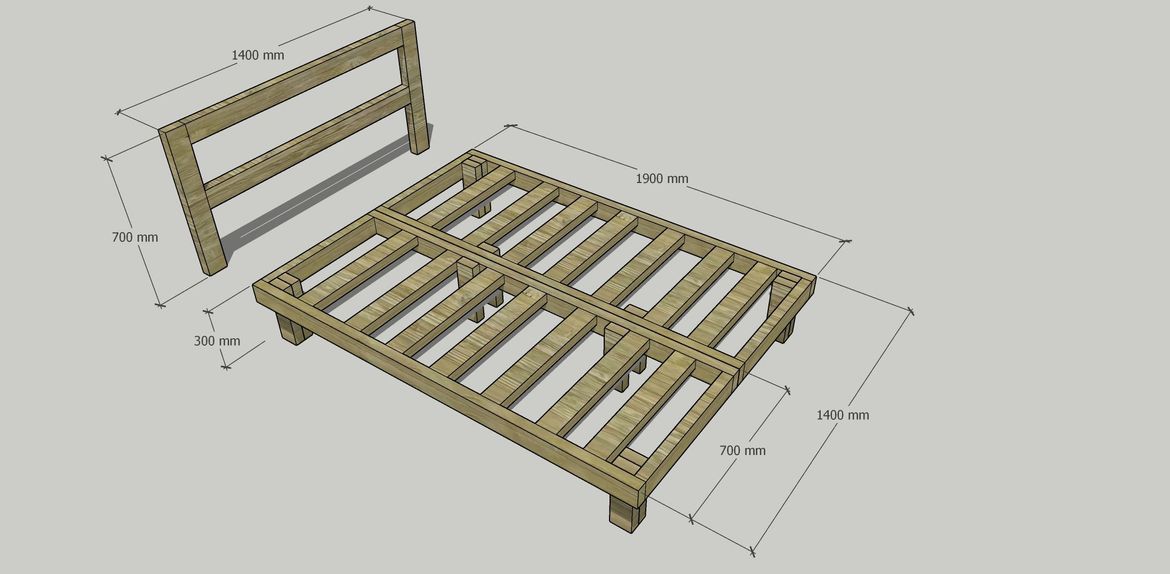

It's great that you've received excellent suggestions from my colleague @MitchellMc. I just wanted to ask if you were building a double bed frame with 90x45? I just wanted to let you know that I've built a pullout bed using 90x45 back in the past. In order to spread the weight and make your bed strong, I suggest doing a double frame and joining them together so that there will be no springiness to the assembly.
I've placed an example of how you could put it together, please let me know what you think.

yes a double bed frame as a loft bed. I was going to use 90x90 posts but I think the 90x45 will hold?
I see- so you mean run the centre brace vertically with 1 for each 1/2 of the bed, is that right? And I see you’ve doubled up on the legs - so
do you think 90x90 would be better?

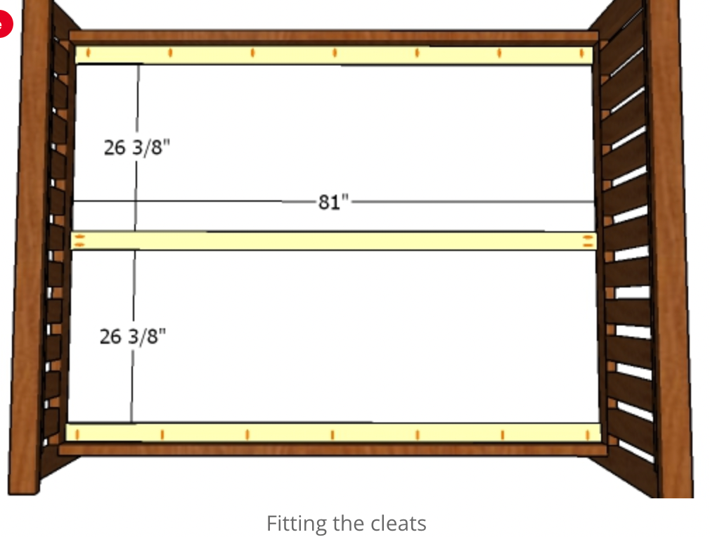

Sorry -more questions - using something similar to below (bearing in mind it is a loft bed so up high) would it work to have 1 90 x 45 centre brace (or even 2) and the slats going the whole way along or best to have it 1/2 size slats as shown in your previous picture? And if I use 90 x 45 as cleats and centre brace, do I need metal brace's under the cleats or at corners for additional support? I was going to use 90 x 45 for the slats too - or do you think that's too much?

It's pretty typical to use 90 x 45mm for the slats. I have two beds using them. One centre brace should be sufficient. However, since the bed is at height, you might like to utilise two.
The need for additional support will likely depend on how well you can secure the frame. You'd only need brackets if you didn't screw the pieces together sufficiently.
