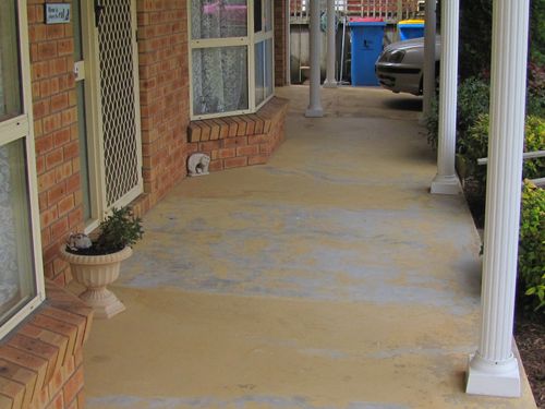

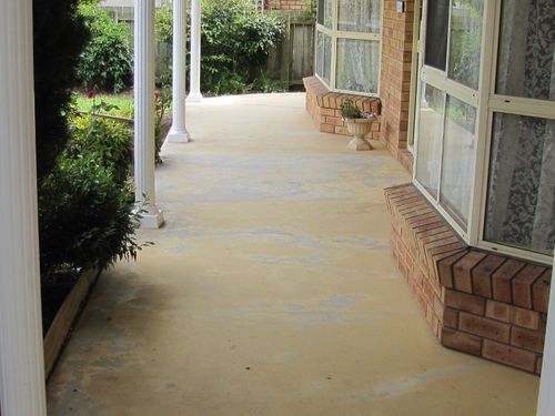

G'day Sean,  I am about to embark on a similar project. I habe a verandah along  the front of the house13.78 ,metres long by 2.1m. It was previously paibnted a yellowish colour, and had  hardwearing ribbed carpet stuck on to it from the front door to the opposite edge, 2.1 m x 1.9. When I ripped this up, it pulled quite a bit of paint and left a swirl of previous glue under the carpet, which being hard , I removed with a belt sander and a Gerni high pressure  washer, I have sanded a lot and feathered most areas. What I am goingt to do is prime the areas  of visible concrete that have been left after  sanding, with White Knight paint with 20% water added. I haven't done this yet waiting for warmer weather. 16 degrees C in latrobe, (Tassie) today.(Christmas Day) When this has dried >2 hours, I shall paint the 1st coat of White Knight Dura pave water based paint, then wait >2 hours and repeat.. There is a vid
eo for painting old painted patio on You tube, plus a separate one for a bare concrete garage floor. White knigh also do a paint for garage, but it also is oil based. I was going to ask anyone if they have done this and atre there any tips available.  This paint has coverage of 10 m2/litre ! and is $88.70 from Bunnings. for 4 litres.  Frank C

The only reason I used White Knight is because I recently used their Laminate Paint  on my kitchen  cupboards and drawers, and was very impressed with the finish and the hardness of the product against knocks that will occur, so I just chose  W K on that basis. I’ve never used Berger so I can’t  compare. I am typing this while waiting for my primer coat to dry, (1 in 5 dilution with water. Paint 800 ml plus water 200 ml ) and it has dried beautifully,. I used a UniPro 10 mm nap roller, and the finish is very smooth, no lines at all.  2 hours is up at 1.20pm  so first coat goes on.

I have never used berger paint before, so I can't compare, but I have just painted the verandah with the first coat to prinme the bare patches of concrete using a dilution of 1 in 5 with water,(200 mkl water to 800 ml paint.)  using a Unipro 10 mm nap roller4, and it has dried beautifully, no lines and very smooth, and uniform in clour . The onl;y reason I used W.K. is because I recently changed the colour of  our kitchen cupboards and drawer fronts, using their Laminate paint and primer,  and was  very impressed with the finish (using a microfibre 100ml 4mm nap roller)  giving a perfectly swmooth finish and it is very hard against knocks, which will occur in a kitchen. Hope this is helpful to you
