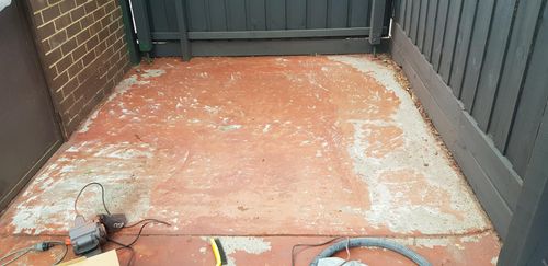

I have pressure washed the old flakey paint off and found there has been multiple coats of red over the years and a final primer/sealer on the concrete. Unfortunately now I am left with an uneven finish if i was too paint over the top at this point. I tried poly paint stripper but quickly realised i would need to buy a lot more of the product to cover the area. I've attached a picture after pressure washing, you can see where i've tried paint stripper (its only bright red because its wet!). My next step will be to use a belt sander and sand back the existing paint (with a good P2 respirator) to and then prep and paint (any recommendations?)

Hi @Peggers. The distressed look came from a lot of pressure washing to see if that would remove the existing red paint.

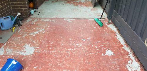

Above picture following sanding(it just sanded back the raised areas of the the concrete):
Above picture following Pressure washing the top section (lower section had only been sanded at this point)
Looking at the top section of concrete: Its easy to see that pressure washing pulled up more paint than i had wanted if i was going to paint over the top. This might have given the paint an uneven patchy look if I painted over it in this state. I am a glutton for punishment and 'doing it right the first time' so I ended up buying the paint stripper and went at it with a scraper and wire brush. This gave me the below after 2 days.
I used about 10Litres of Poly Paint stripper to do 16m2. (The instructions recommend 1Litre per 0.4m2) Sanding definitely helped the paint stripper do its thing so it wasn't all in vain.
