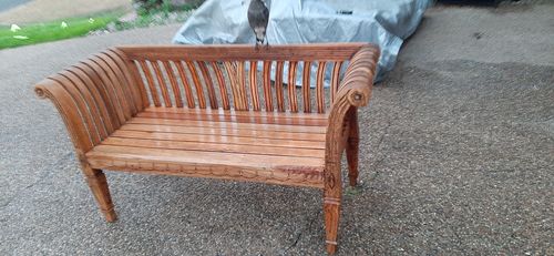

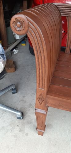

Hoping for some advice from some of you seasoned timber furniture re-furbers.
I was gifted a day bed in bad condition, had been left outdoors, under partial cover for 10+ years. I have just sanded back all (almost all surfaces except tiny spaces I can't get into) acid washed it and now wanting to repair some.damage and re-finish it  I was thinking of staining, shellacing and then waxing it (never done it before, but it sounds like fun!) Thing is, the timber is very thirsty in my opinion and really needs some love in that department.  Should I "feed" the timber with something (if so what?) AT ALL or just carry out the stain, shellac and wax?  If feeding, should it be done before or after I stain?  I have already purchased my stain, shellac and wax, so really have my heart set on giving it a go.
The pics are taken this arvo after I acid washed and rinsed off, so it's still wet, I totally forgot to take a true BEFORE picture, many blonde moments here LOL

Nice that you want to do a traditional finish rather than going the much easier poly finish.
It may just be the photo but the colour on the back seems to be lighter than the back leg?
I will give you some light reading that includes the authors thoughts on using a restore product before staining.
https://thecraftsmanblog.com/how-to-prep-wood-for-stain/
If there is sun damage then I may have to dig deeper into fixing that.

The colouring of the woods certainly was lighter/darker on some areas when it was wet. It seems to have evened out a fair bit since drying  I plan to wet it down again and allow it to dry before I proceed with the stain so I'll repost when I do that, currently working on my greenhouse for the next few days.  I'm Hoping it's not beyond help, I'm not even sure if it is all made out of the same wood. Thanks so much for the link, I was surprised to learn that plain old water could be just as effective of a wood conditioner than something extra I'd have to pay for!

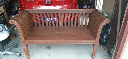

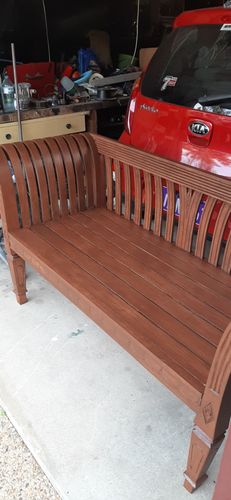

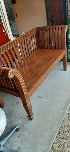

Thank you for the wonderful advice  I have applied my 2 coats of stain and I must say that I'm not really all that fond of the colour.  I intended to apply garnet shellac and thought this may tone the brown colouring down for me, but after reading quite a lot of advice here and through links, I am now having second thoughts. The day bed will be placed on my covered patio and although not out in the open, it will still be outside, so I think I may need a more robust finish, can anyone please offer their advice on this as I won't go ahead with my finish, I don't want to mess it all up and have to go back to bare wood again.  Also thinking about the shellac and wax finish, I think it may have been a little ambitious on my part, the sanding and staining was so very consuming and I know every surface is not perfectly smooth, the only way to do it would be to dismantle the piece and that is a little beyond my patience. LOL Through one of the links in a previous reply, I read about a home made finish containing satin polyurathene, boiled linseed and mineral spirit, applying 6-8 wipe on coats, do you think this may be a better option for my finish? It sounds a lot easier for application, I hate brush marks!
