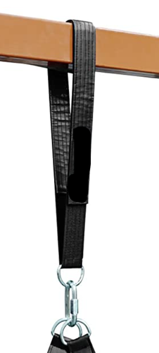

@goncoza I think your choice ro move the bag to the location @MitchellMc suggested is a good one. To further reduce the noise made, similar to what @Noyade suggested, if it were me I would tie a carabiner or D-Shackle to the bottom of the beam with a strap (as tight as possible), and then hang the bag from that. It should reduce the lateral forces being applied to the beam as the bag will only be swinging from the bottom of the beam whereas as it is currently tied the whole beam is involved in absorbing the swinging motions.

Hi @tom_builds , thanks for the observation, do you mean something like the photo below?
