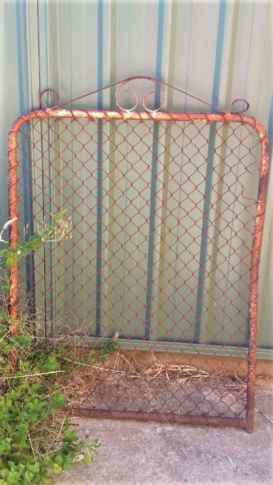

Any ideas on how to bring some new life to this rusty old steel gate?

I have gone with a bottle jack and clamps/tack welds to straighten pipe. You would  need to take the wire off.
Having a pipe bender I would now try puting the pins as far appart as I could and press on the high spots with the correct die.
