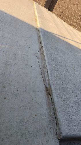

Our concrete apron was completed in September last year (approximately 5 months ago). We’ve recently noticed a few issues, including:
1- Some fine hairline cracks
2- One more noticeable crack along a formed step-down / construction joint (intended for future paving), which has opened to approximately 1 mm
3- Minor chipping along several saw-cut / control joints

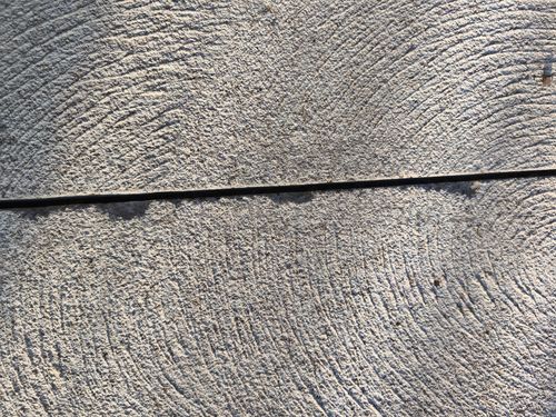

We understand that some cracking can occur as concrete cures, however we’re unsure whether what we’re seeing is considered normal shrinkage or whether it may be related to workmanship, joint detailing, base preparation, or ground movement.

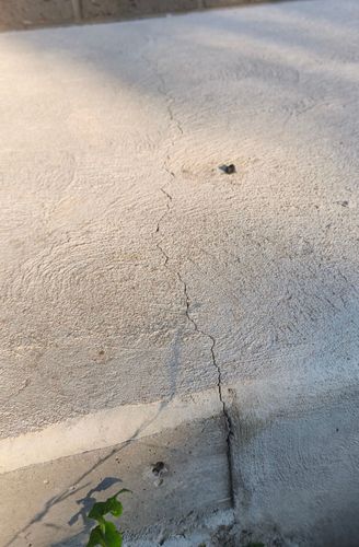

Thanks all for your replies. Just to clarify, our main concern is not only the fine hairline cracks, but also a more noticeable crack (approximately 1 mm wide) that has opened along the formed step-down / construction joint intended for future paving (second photo). Could this be due to absence of appropriate expansion material (for example, compressible foam at the step-down) to accommodate movement?
We have contacted the concreter to inspect the work; however, he is pushing back and has advised that, per his "terms and conditions", he is not liable for any cracking, chipping, or shrinkage, attributing this to ground movement outside his control. He has said this without an inspection.
From an industry perspective, would cracking and chipping at control / construction joints within only five months be as the result of ground movement?

In your first image, the chipping of the edge at a control joint and along the edges is not unexpected and is generally accepted industry-wide. Unless, of course, you've paid for additional work, a high level of finish in those areas.
The real issue is the cracks across the slab. Once again, hairline cracks are acceptable, but larger open cracks may indicate that additional control joints could have been used there. As @Nailbag mentioned, you would need to enlist a consulting service. They would be able to let you know whether the slab has been built to construction code standards.
