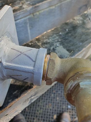

A warm Sunday morning experiment.
Regards the thread tapering.
Tap and gal fittings below are from Bunnings.
There is no way, by hand, I can insert the tap any further. Tapering binds the tap for a better watertight fit.
20230115_095139.jpgHand tight insertion.Hand tight insertion.

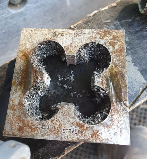

I definitely know the P&N pipe die produces a tapered thread that binds after a short distance - you simply cannot cut any further.
The outdoor taps I have - none are able to utilse the full tap thread into the gal elbow even with a pipe wrench and shifter.
Good thing methinks.
