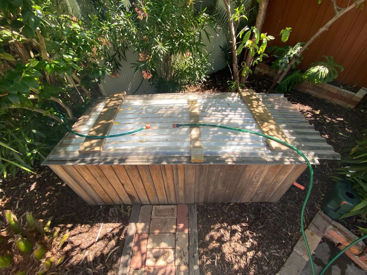

This is the bath setup. The hose on the left provides hot water, and the hose on the right provides cold water.
What I was looking to build was an outdoor shower setup, where you just plug in the hot and cold hoses when you want to use it, with the ability to change temperature etc.

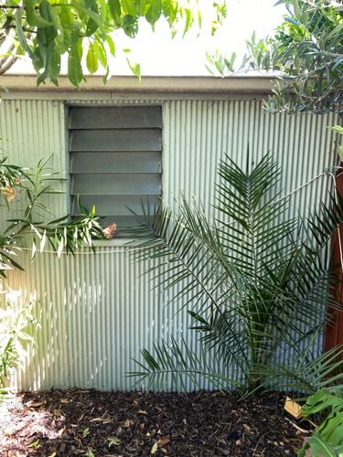

I will build the wall for the shower fittings to be attached to, it will be going somewhere in this part of my garden:
What I was wondering, what fittings would be required for me to connect these two hoses to a shower setup? They would only need to be plugged into the shower whilst in use, similarly to the bath. In regards to draining, I was happy for it to just drain straight into our garden.
