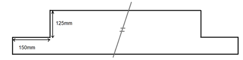

2. You will then cut a rebate out of both ends of the 2000mm bench seat sections. The rebate will be 150mm from the end and 125mm wide. This rebated section will fit through the legs.

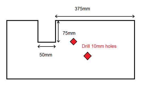

4. You'll need to notch out all four legs pieces now. The notch will be 75mm x 50mm and is located 375mm from the bottom of the leg. You can then drill 10mm holes beneath this notch for attaching the braces.

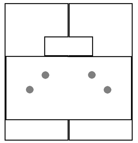

5. Take the two leg halves placing them together and place the 400mm brace section directly below the notched out portion of the legs. Drill four holes in the brace matching the locations of the holes already in the legs. Insert your bolts through the holes and tighten the braces into position.

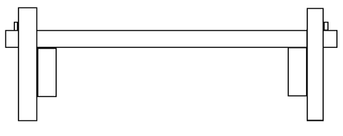

Please let me know if you need further assistance with this project or had any questions.
