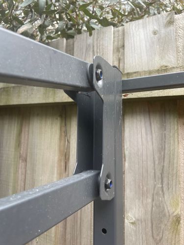

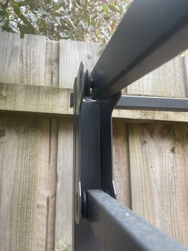

Our clothesline is also broken, wondering if it could be repaired. The left arm wouldn’t click down initially so I thought I needed to put a bit more force and now the joint is bent, the clothesline still won’t go down
Welcome to the Bunnings Workshop community @LMB. It's great to have you join us, and many thanks for your question about repairing a clothesline.
I see you already found a previous discussion with a similar issue: How to repair a folding clothesline? Our members go over some possible methods of fixing there. In your case, it looks like you'd need to un-bend that joint and then secure it in position. Perhaps reposition it by lifting the left-hand side of the clothesline so it's in line with the right and then screw through the joint with a few self-tapping screws. However, clotheslines have to deal with quite heavy loads, so any repair might only be temporary.

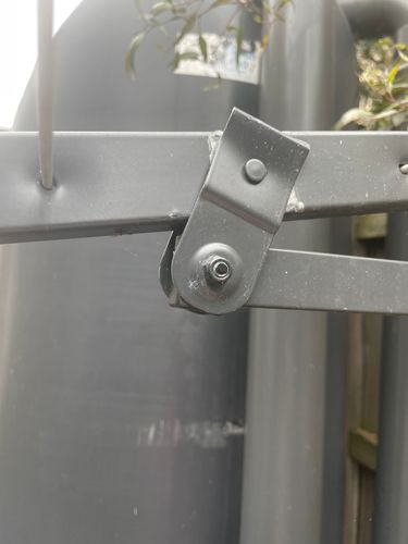

Hi @LMB

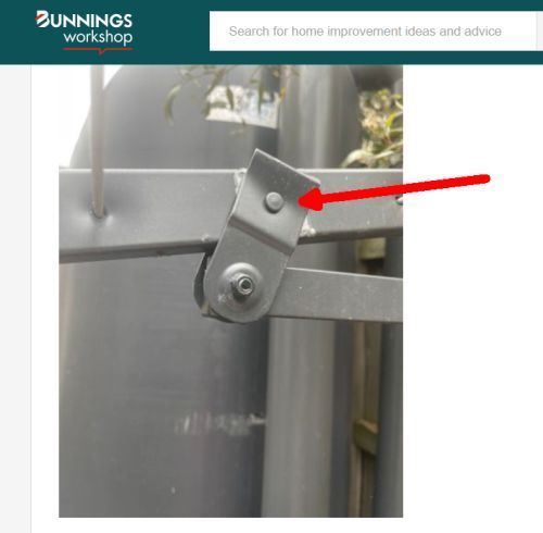

Is this a double-ended rivet or a bolt?

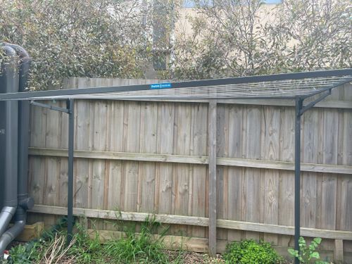

Thanks for sharing your question about your folding clothesline. I suspect that the locking mechanism for this unit is located inside the support arm and when you applied pressure to it, the default locking position moved out of place.
It might be possible to push the clothesline back into place, but the locking mechanism might already be damaged. I can see from the sticker that this is a Daytek clothesline, would it be possible for you to tell me the model number and colour of the clothesline that you have?
I'll make some inquiries for you and try to find out if the support arm is sold as a spare part.
I think it’s a rivet, I can’t unscrew it
I can’t find the model but I think it’s the daytek fold down clothesline. The colour is colour bond monument

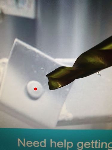

"I think it’s a rivet, I can’t unscrew it"
If @EricL can source a new arm - my thought is you still have to repair that connection?
Provided it is a double headed rivet pin - "I propose" accurately centre-punching one head and drilling the head off. Punch out the pin.
Remove the bottom bolt and now you can disassemble the two plates. They look like they need to hammered back into shape.
Reassemble and now use a nut and bolt in place of the riveted pin.
