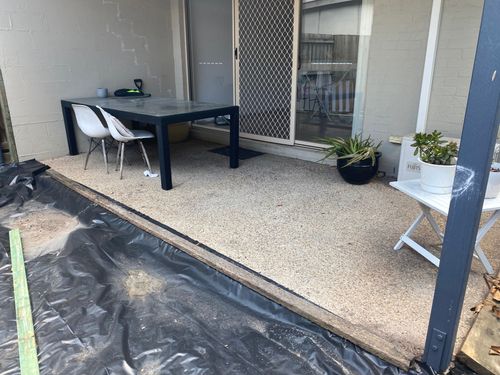

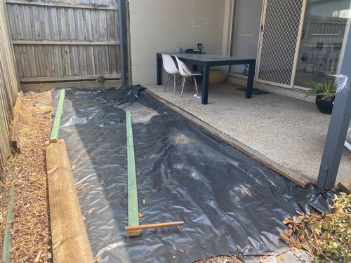

Although I’m not at the house at the moment, here are a couple of pics that I have on file.
FYI - the tree, plants and old sleepers have been removed in preparation for the deck.
The distance between the house door and the patio slab is 1250mm .
You’ll notice that the garden is pretty level with a drop of about 1400mm from the slab to the garden area.

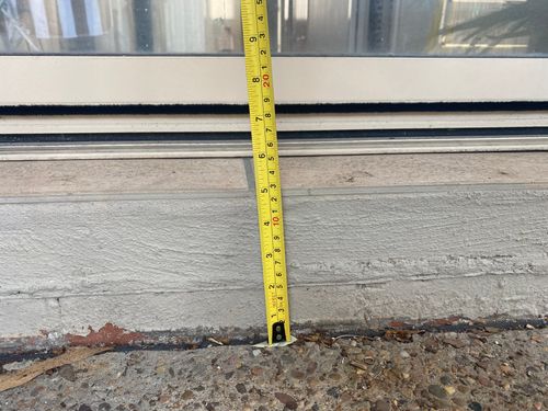

I've placed a picture to indicate the gap that I was referring to in my last recommendation. This gap will determine if it will be possible to build a low-level deck on the cemented patio area. When you get a chance to go to the property, please measure this gap and the height of the cemented area.

Hi Eric,
Yep, the distance between the concrete slab is 1250mm.
1500mm to the bottom of the door frame.

I believe @EricL's confusion might be due to your measurements being slightly off. They should be 125mm and 150mm. You've got an extra zero in there.
With that amount of room, you'll be building a single layer deck, and 90 x 45mm outdoor treated framing timber would be suitable for the joists. It's what most of our members use in these tight situations. Our members also typically work with a 450mm spacing for joists. With 90mm for the framing timber and 23mm for the decking, that leaves you with 12mm for water drainage and airflow under the frame. In Eric's image above, you'll see that the framing timber is then attached to the concrete slabs with angle brackets, and plastic shims can be used to keep the spacing uniform.
Once the deck frame leaves the concrete slab, it doesn't look like you'll have enough room for a joist over bearer frame. You'll likely need to support the joists individually unless you're going to excavate a substantial amount of soil. Compacting the ground and placing pedestal feet on concrete pavers could be an option.

You generally wouldn't consider a joist of bearer frame when working that close to soil @GaryL. In your circumstance, you'd need to remove up to 300mm of soil for clearance and then lay a layer of gravel for drainage. The minimum size bearer you could possibly use would be 90 x 45mm.
Instead of having the bearers, you could have supports at the 1125m mark and then again at the 2250mm mark. The joists can have their ends connected to a length of timber running perpendicular tying them together.
