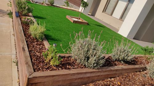

I have merbau edging on the frontyard lawn that boxes a 10 by 12.5 ft artificial turf. It's been installed over 6 months ago and have been weathered by the elements. I plan to apply a Cabot Deck clean (https://www.bunnings.com.au/cabot-s-1l-deck-clean_p1521451)
Once dried, plan to apply Cabot Aquadeck (https://www.bunnings.com.au/cabot-s-aquadeck-merbau-exterior-decking-oil-4l_p1520084). Will this improve the look and longevity of my frontyard? Also the area should be around 180 sqft. So will 3 litre of deck clean and Aquadeck decking oil be enough? Please share any more feedback on my idea.

Just to clarify, are you only planning to stain the edging next to the artificial turf or the whole retaining wall?

The deck clean goes a long way as you dilute it so one litre should be more than enough. And I'd buy the 4L tin of the oil as you'll need to reapply regularly and it's much better value than buying in smaller quantities.
Agree with @MartyH on the quantities. Reapply after 6 months, then once every 12months thereon and you should keep a beautiful looking timber edging.
