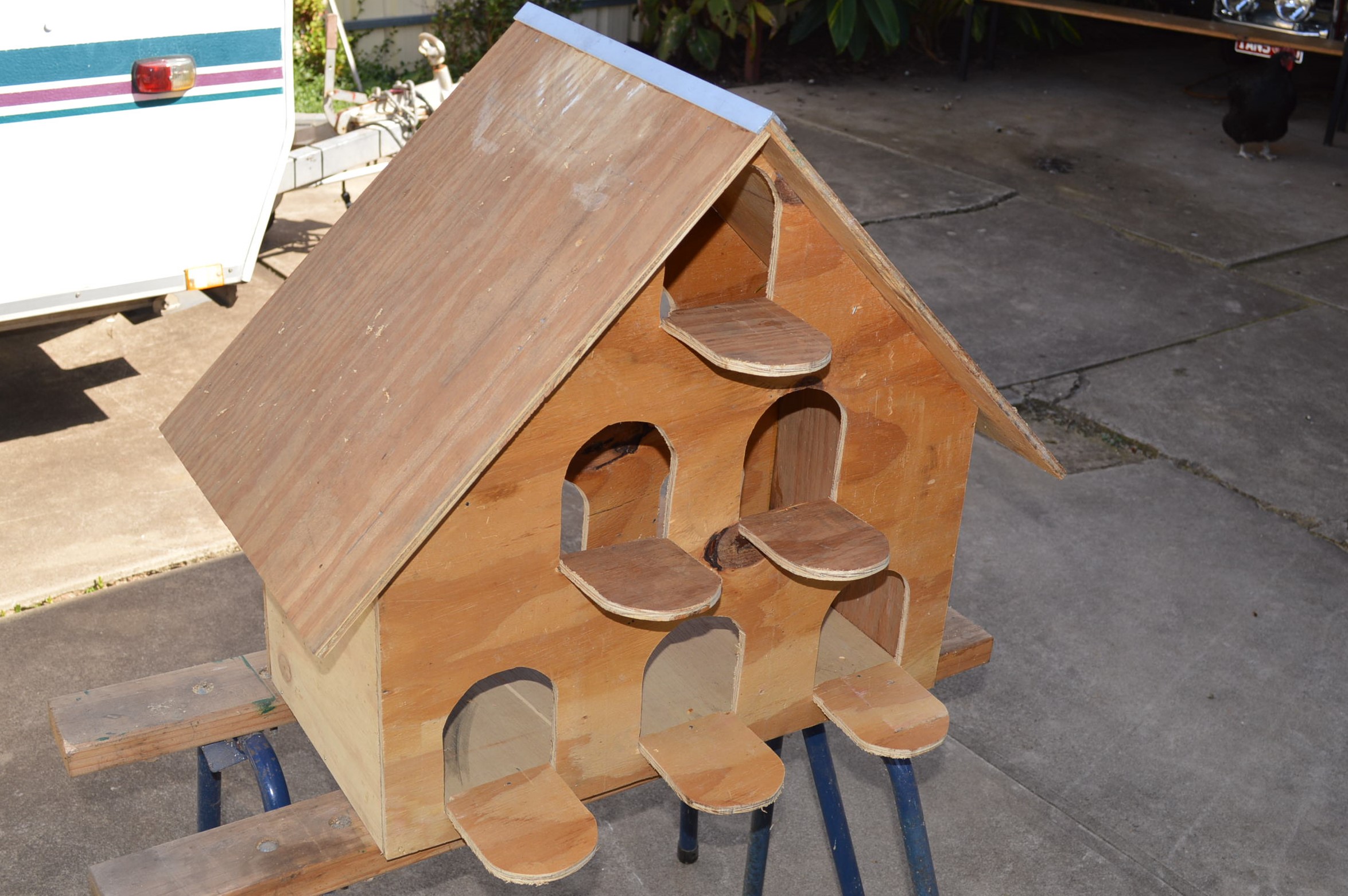

What glue and screws/nails should I use to construct a freestanding 12mm thick structural plywood dovecote which will be outside permanently.

If it is a dovecote and not a loft you may not be popular with your neighbours especially when they have washing out.
My go to outdoor glue is Sikabond PVA.
First choice screws would be Spax-m if I didn't have a Kreg jig.
Poor 2nd is countersunk chipboard screws 8g at least 30mm long and I would drill a pilot hole to try to avoid splitting.

Thanks for the advice. Got the glue as reccommended.
Bunnings had never heard of the screws. Got counter sunk chipboard screws, the second option.

Not surprised since it is not a standard bunnies item.

Looks great @Bulldozer. Thanks for sharing.
Is it for pidgeons? If so, do you race them?
