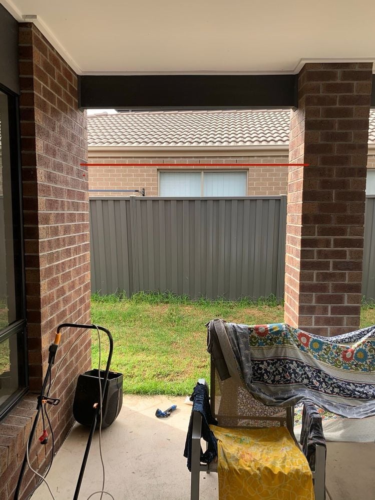

Hi, I'm thinking attaching a rod between these 2 pillars so I can hang different sort of swings for kids. or can also use as pull bar ;).
Distance between pillars is around 1.7 meters. Any suggestions on feasibility of it? also what stuff should I need. It should be able to lift around 200kgs.

1.7m is a significant span for any rod to support 200kgs. I'm sure it would seldom see a full 200kg and not directly in the middle which will cause the most stress and flex. If you could get a rod thick enough to support that weight, we would need to address how to mount it. You could drill two holes either side into the brickwork, but then one would need to be deep enough to slide the rod into then back out again into the other hole. We would then need to use a Ramset Chemset 101 Injection Kit to secure it in place.
A way around this may be to have support in the middle if you can find a ceiling joist located conveniently. If there are joists available, perhaps you could consider creating a fixing point for the swings from there instead of a bar.
If you did want to go with the bar idea there is a range of threaded galvanised pipe which could work if supported in the middle.

I would tend to agree with @MitchellMc with the chemset although I am from the old school way of pipe flanges and dyna bolts which looking around home with the rails put in by DVA Homecare there are better ways now of doing things.
I have a hose reel dyna bolted to the wall that my mother in her late 80's could rip out the wall, not a bad effort for someone 55kg to exert 2800KG force. My partner at around half that age and a similar weight may test out some chemset added to the holes.
Thanks Mitchell for the advice which totally makes sense. Support in the middle would make things a bit more complicated for me to handle and it absolutely required as when my kids' cousins come in they don't respect weight limit on anything
so what I'm thinking now is to go simple as just use the full swing set |T| and just anchor it to the pillar and on the ground. Thanks for the guidance! ![]()
