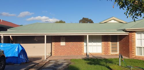

Hi all, Im planning on removing the existing front verandah as its old and has some rotting. We also dont like the curved roofing, which makes the house look small. So instead going for a flat roof, opening out the front of the house which will be rendered soon afterwards, along with a fresh paint on the roof as well.
The existing structure is 10.5m long x 1.4m wide (width is from the facia rather than the brick wall), has 3 posts as seen on the photo. The middle post is actually not aligned with the garage door.
My question: instead of the middle 2 posts, can i have one post in the middle at the 5m mark, while using 112x112mm posts for the the corner and the centre. Currently have 185x42mm beams, and was wondering if thats sufficient support or should i go with th 280x42mm.

I am no expert Imesh, but it looks like your post placement currently matches with the joins of different sections of beams? Which means you would need new beams to span further if you want to minimise your number of posts.
This is where you need to understand how it is attached to the house, the different measurements on all the current parts of it/what you want to build and start checking span/roofing tables.
Bit of work there, but there is always a solution. You could also look at using metal beams which can span greater lengths and use their poles and connectors. A few things to consider here.
Certainly wait for an expert with more roofing knowledge though.
