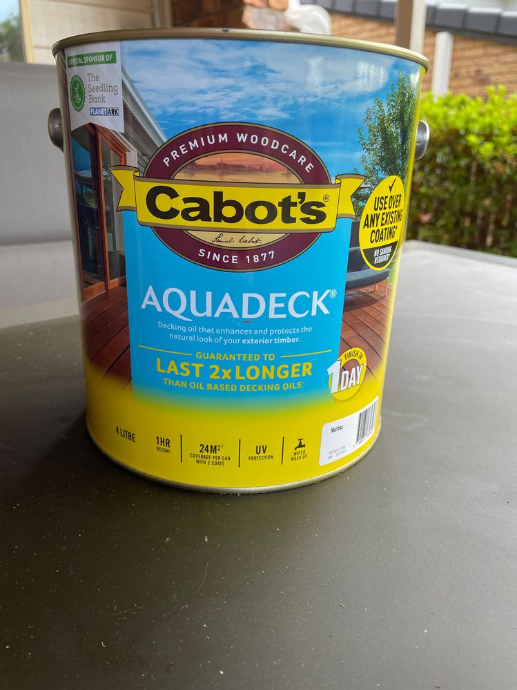

I believe this is treated pine wood. We've got this put in just a month ago. Could you please advise what type of paint is suitable to paint over the timber so that it lasts longer. I prefer a darker colour. Thanks Thanks

Thanks for the info Eric. I picked this up from Bunnings. The paint is water based so just wondering if oil based is better as the timber is exposed to sun and rain? I am worried if I use the wrong product!
I would say at this point in time they are just as good as the oil-based products. If you prepare the surface of your retaining wall properly the paint should work with no issues. You can always test a small corner first if you wish to see what the stain is going to look like. My best advice is to use a good brush when staining your retaining wall.
