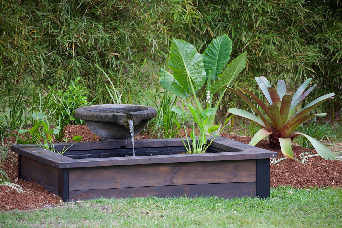

I've attached a pic showing the sleepers I painted. This was with only one coat.
