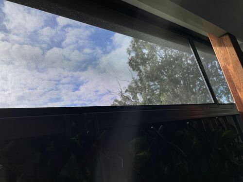

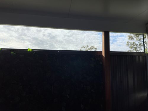

I have completed my fly screens between the fence and pergola roof and attached photos.

I used the Pillar frames and cut them the length of my posts 2.3m so the joints are behind the posts.  I stuck the 16mm L shaped metal angles on the top and bottom for the screens to lean up against.  I had made the fly screens and then applied liquid nails on fly screens and stuck them against the angles.  There is a bit of space between one of the fly screens and the fence, as the fence is not straight so I filled it in with the same colour silicone (sika roof gutter silicone).
I have used the strong Cyclone aluminium insect screens so hopefully they will last a few years.
