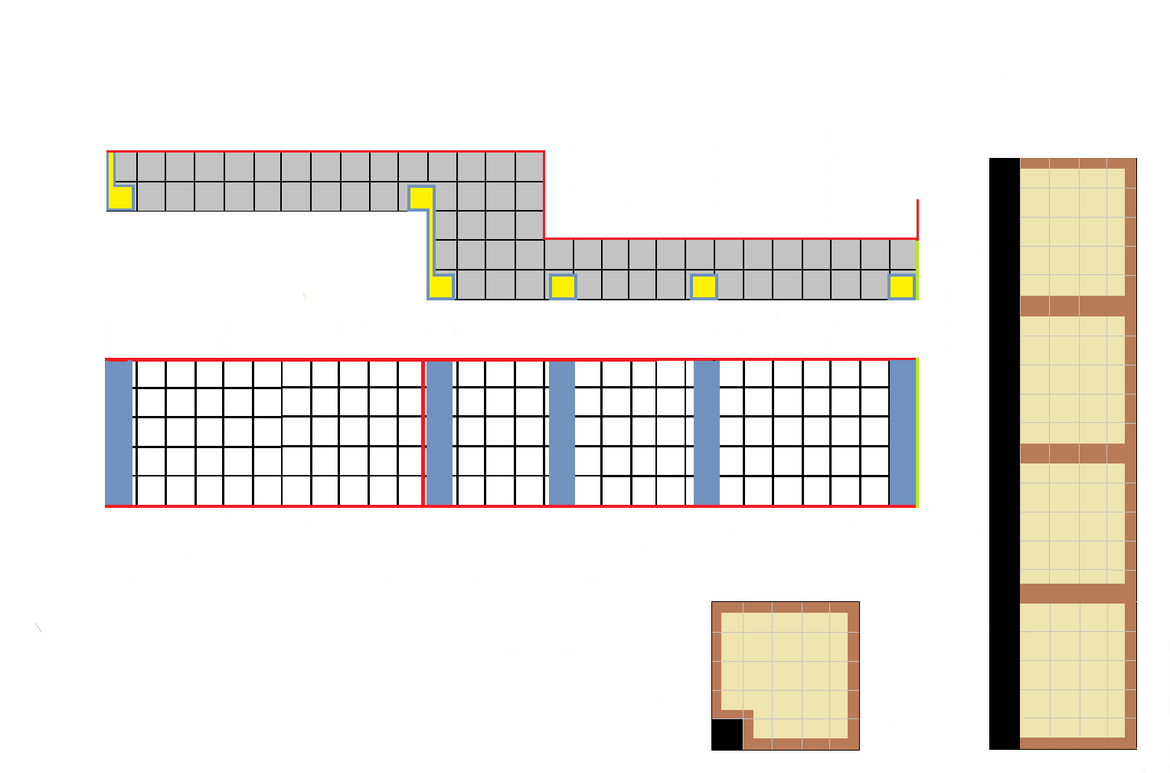

I have done a plan which should give you an idea of the size of the project.
Note the Galvanized Posts are 65mm square, not 75 as previously mentioned.
Am I taking the right approach on this?
I was wondering if the Blueboard could be glued, rather than nailed or screwed, although I do have access to a gas nail gun, but wonder if it would penetrate the Blueboard?
With the 300mm blueboard, is it necessary to create a recessed edge, where there is no recess present?Square Grid Front.png What is a good way to do this?

Here's the James Hardie blue board product page with details about its application. You'll also find the installation guide with specifications on how to fix it and how to set corners. A nail gun can be used for fixing the blue board and the installation guide covers this also.
The recessed edges allow the corner pieces to be mounted flush with the boards surface and therefore concealed easier. You can use tape instead of corner pieces in the absence of the recessed edge but the tape does not give you as much protection to impacts.
