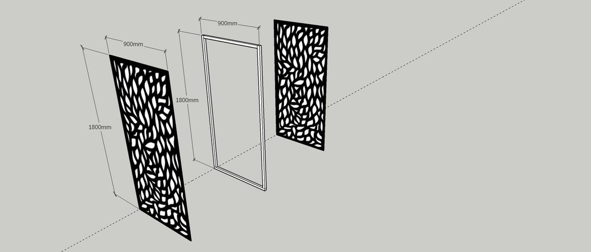

I am looking for advice on how to install these panels as alfresco doors.
What rollers do you use and do they need to be in a track or can they be connected somehow?

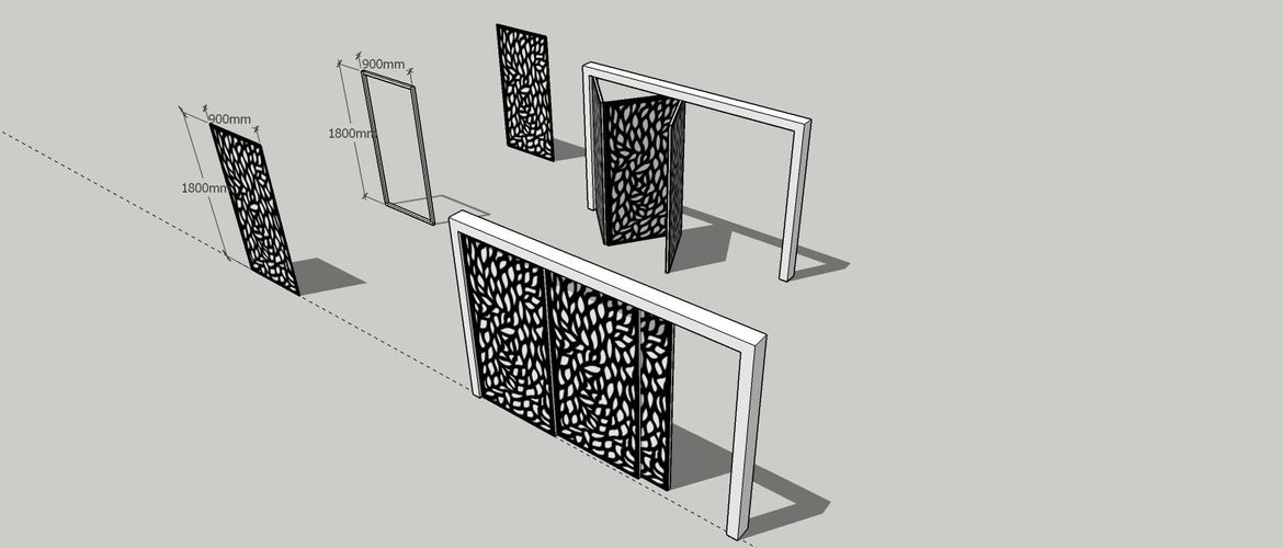

Thanks Mitchell. I require 3 panels, so 3 tracks.
Would it be easier to do as a bi-fold door?
I believe trying to create a bi-fold door would add another layer of complexity once again. It's one thing to fix rollers to the top of the panel and have them slide in a track, but to create a concertina system with hinging and then also have them moving in a track would be another story.
You'll find alfresco doors, either in a sliding configuration or bi-fold, are normally a system you purchase together. It consists of the track system, frame and doors which have pre-installed guides, hinges and rollers attached to them. One of the main issues using the matrix panels for this is that there is no significant thickness to install rollers, hinges and guides on.
Hello @MariaB
My only suggestion is to make sure the timber or aluminum you use is rated for outside use, along with the fittings, runners and wheels you will be using. I suggest a timber size of 30 x 30 as a regular door is about 35mm to 40mm thick a display panel is about 3 to 4 mm thick, all joined together is about 36mm thick. Perfect for alfresco doors, please make sure the timer is treated and is rated for outside use. Because the panels are 1800 x 900 and 1200 x 2400 those will be the dictated size of your doors. After building the frame you can glue then screw it on to the door frame. Your choice of either sliding or folding doors. Good luck and stay safe.
