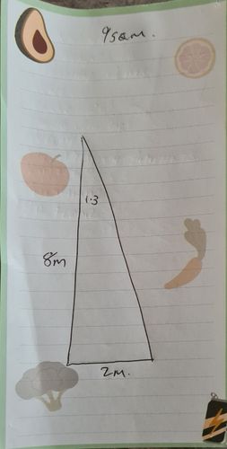

Hi Mitchell  thanks for your reply. It's a triangle area base is 2mts, longest side is 8mt.
450 pavers does sound right for such a small area. My neighbour told me is would round out at 8-9sqm total. But if your saying I would need 450 pavers, something doesn't sound right 🤔

I've triple checked my math, and it appears correct. These are only tiny "pavers" the size of bricks. To do one line, 200mm high at the bottom of your triangle out of the 8000mm, it would require 20 pavers. Since this is a triangle and not a square, the pavers will need to be cut, and you'll potentially need more than 450 to complete the job. However, by my calculations, the area is right on eight square meters, not nine, which is more like 401 pavers.
To verify, check out some online paving calculators. They let you put in all the measurements and spit out the number of pavers you need for the job.
