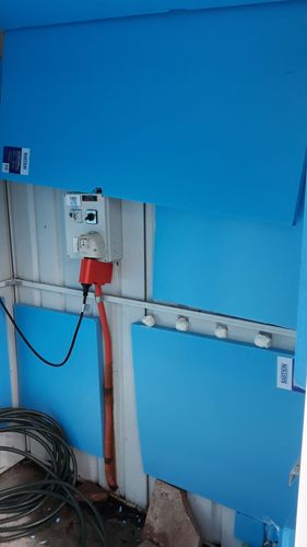

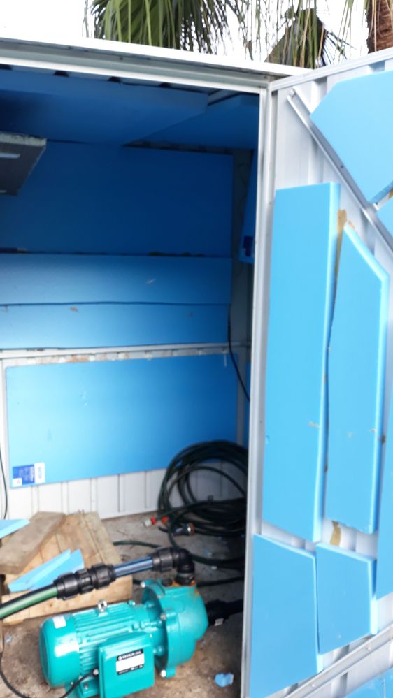

Good Afternoon @VanS1
Looking at that photo of inside your shed I was wondering if it was possible to have a few more photos of the inside of the shed including the roof.
I see a shed as an oversized cooking pot, its going to bang around unless you have a decent amount of sealing with insulation to stop it. With that photo I can see large gaps which would still reverberate with reflected sound and create that hum you can hear.
Options to consider -
- Redo the insulation you have to cover ever bit of the shed walls and roof.
- Build a cover that can safely sit over the pump itself, something like a cowl that will absorb the sound but still be able to be removed if needed. I prefer this idea as its less resources to do.

Besides additional shed sound deadening the way the pump is located on the floor you are good to also make a sound deadening box to cover the  pump. Built in such a way so it can be installed without tampering with any of the connections.
If that's the case sit the box on top and use something like this.
And secure with screws.
