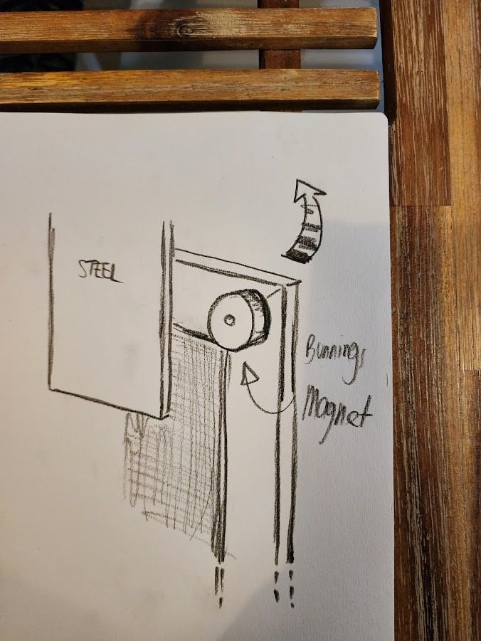

The OT proposed magnetic devices (Maybe These? ) from the ceiling. On the ground they would be tripping hazards.
Would these magnets hold a screen door with a self-closer?
Any thoughts/suggestions welcome.

Back from Bunnings  - I'm sure I looked a right idiot in the aisle testing the 'magnetic forces' within plastic packets and against the steel shelving.
I bought a few - but just now tried the Adoored style.
Impressive holding power.
I fitted the magnet as an experiment - I'm holding the door open against the self closer, with ease.
But I'll see what happens when I go with the top of the door against the 'stalactite' ceiling holder.
(Tip : if you buy one of these - no instructions - but you need a large flat screwdriver to undo the base)
Cheers. I'll document my progress.
