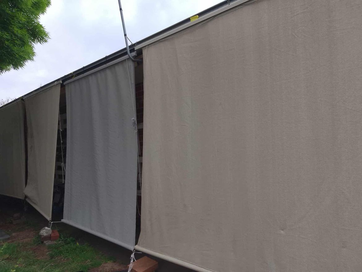

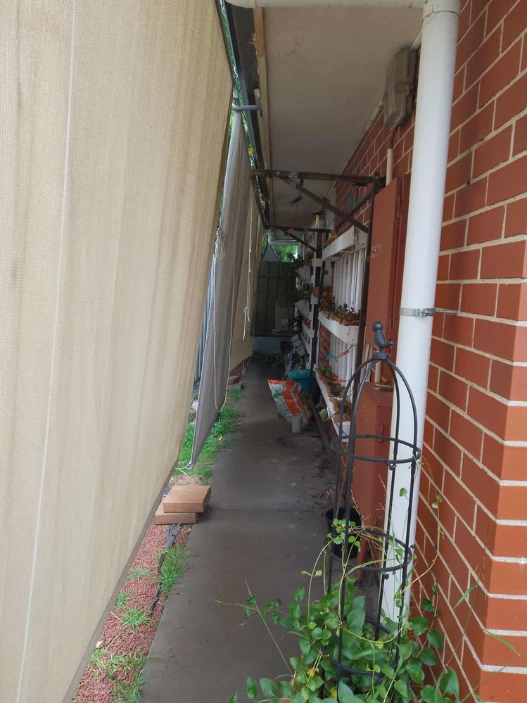

I attached photos as advised to show more clearly what the area looks like. that wall only has one smaller (bathroom) window actually but we are aiming to keep the building passively cool as possible and this is still is on the west side. We do have a big tree as well and the window I mentioned has honey comb blinds and EPS board during hot days.
I can understand the logic with creating an air gap or doubling up the shade clothes but if there was a way to create more of a thermal mass to cut down the heat? that would be nice, summer times the hot winds don't seem to achieve much in terms of cooling if the idea is to ensure ventilation. Hence my suggestion if something could clip on and off as needed so to make use of the more cooler breeze as well.

If you add thermal mass to slow transfer of heat, its still going to shed the heat during the evening... So I dont know if that type of deal would work so well. Looking at your shade cloth screens I am thinking of a mister between the wall and the shadecloth spraying the shadecloth ish. The evaporitive effect would work well. Kind of like the Indian styled cooling walls with terracotta pipes and water. Water passes over/through something abd evaporation happens which causes the area to cool.
You have in effect an air gap now between the screen and the wall. Adding cooling to it via misting would be the easiest first step.

I think @Dave-1's suggestion is spot on. I suggest using Nylex 24m Premium Misting System Kit in combination with Pope 300kPa Pressure Reducer which will prevent damaging the misting system. The combination of the mist and getting your roller blinds wet will create a traditional cooling effect. As the wind passes through the wet weave of the roller blinds it will cool the wind down.

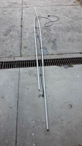

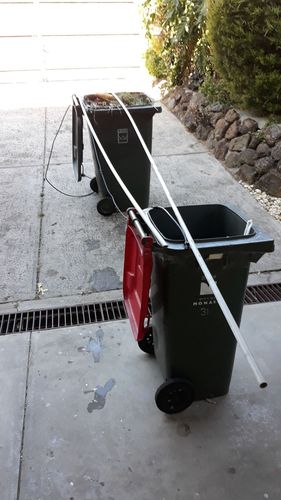

Misting poles-
Another take on @Dave-1's misting suggestion.
Cabled tied to electrical conduit.
Misting systems don't use much water, the tap needs to turned down low and it takes some fiddling to get the right flow so I use the Holman 12mm Twist Flow Hose Fitting Connector,
Located in each line near the misters which saves trips back to the tap to give it another tweak.
In your case I am thinking to also use a soaker hose on the outside of the blinds.

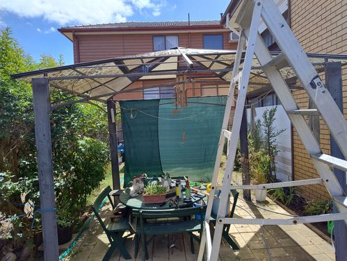

I have shade mesh on the sunny side of our freestanding Mimosa gazebo.
To 'soft anchor' the screen I use short bungee cords hooked into tent pegs hammered into the ground just below the surface so they are not a tripping hazard. You (@Vitriolum) could do the same thing which gets rid of the rocks/bricks/pavers and looks tidy/safer.
