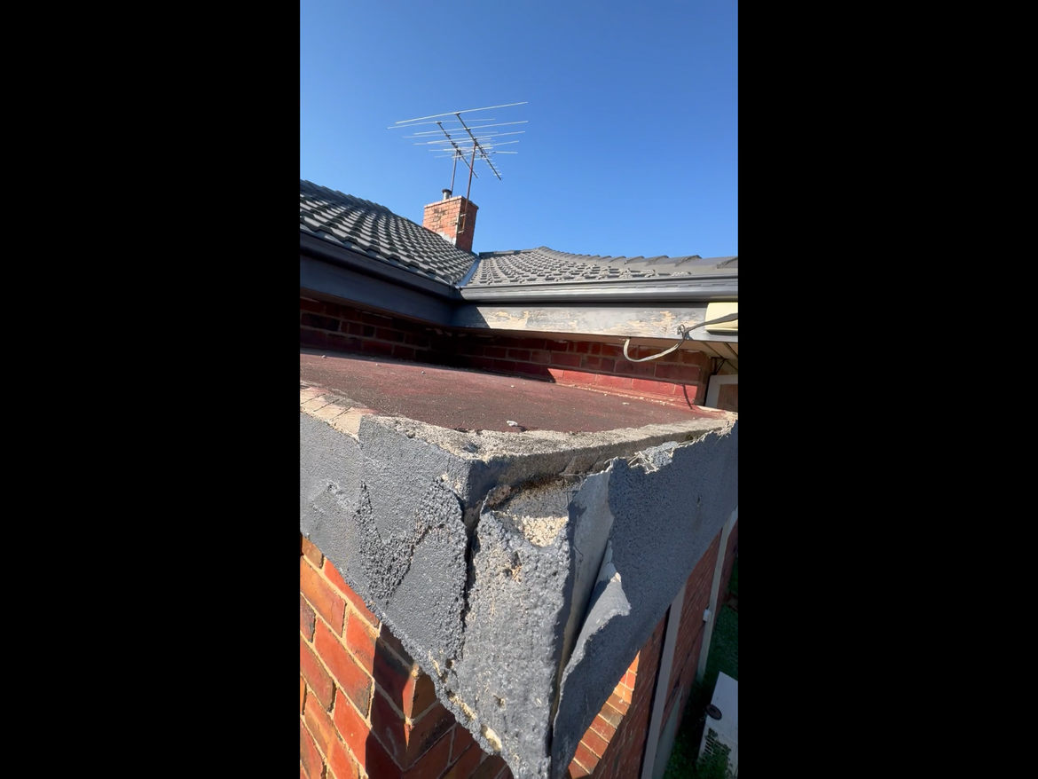

Roofer broke off cladding
I need something better than glue. Any suggestions please.

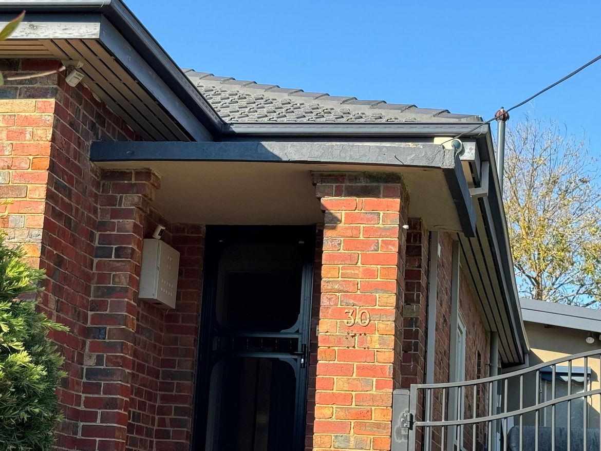

Hello. Recently we had our roof tiles replaced.
The roofer used the concrete roof over the front entrance for access to the roof.
The polystyrene cladding broke and fell off.
Now I need to re dress the edge of the concrete to reclaim the street appeal the house previously had.
If anyone has a better solution than rendered polystyrene I’m open to any suggestions.
I believe polystyrene was used because the structure isn’t its best and it (polystyrene) isn’t a heavy load.
I am hoping for a better, stronger hanging/ joining solution than the glue that was previously used.
Any advise would be greatly appreciated.
Thanks in advance
Philip from East Malvern

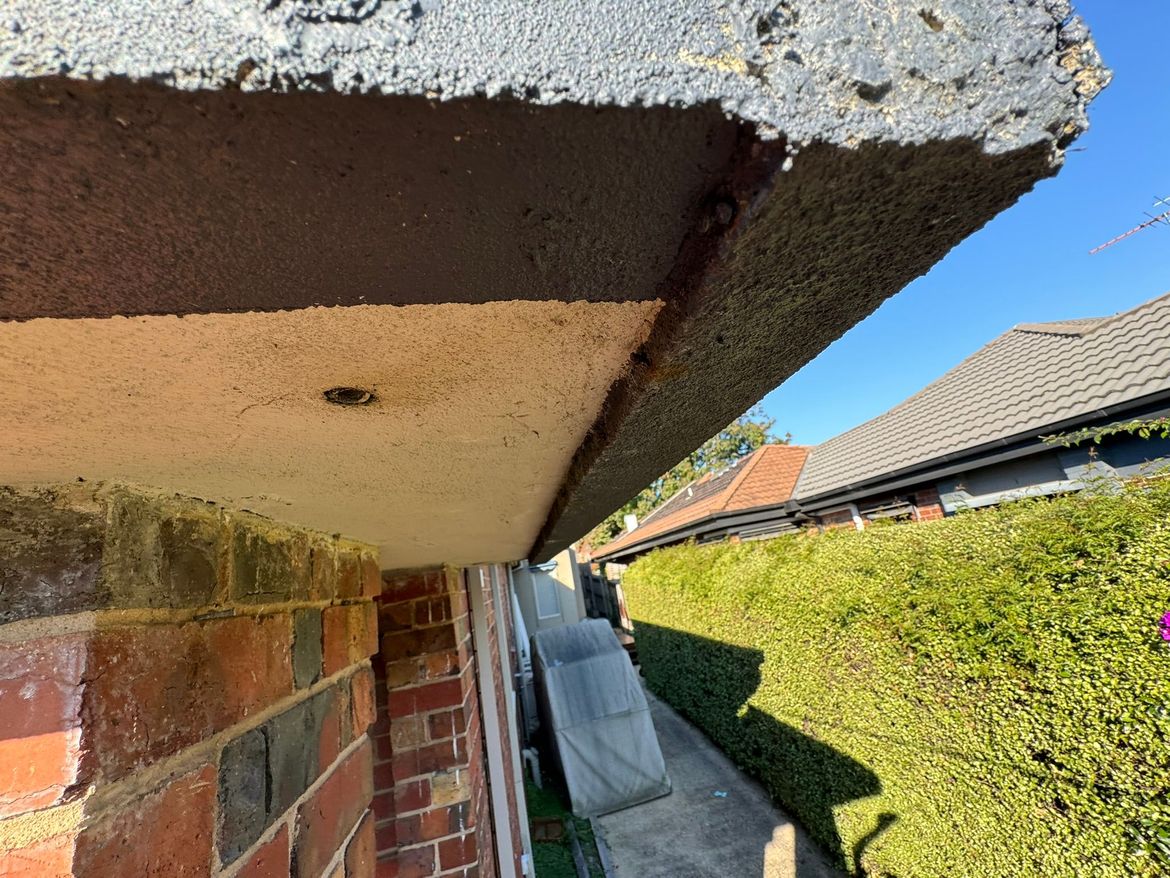

The surface the cladding was attached to was concrete. The entire landing roof is concrete.
I painted the face where the cladding was so it wasn’t so in your face.
Before painting I removed the glue and removed loose powdered surface to get to a paintable surface.

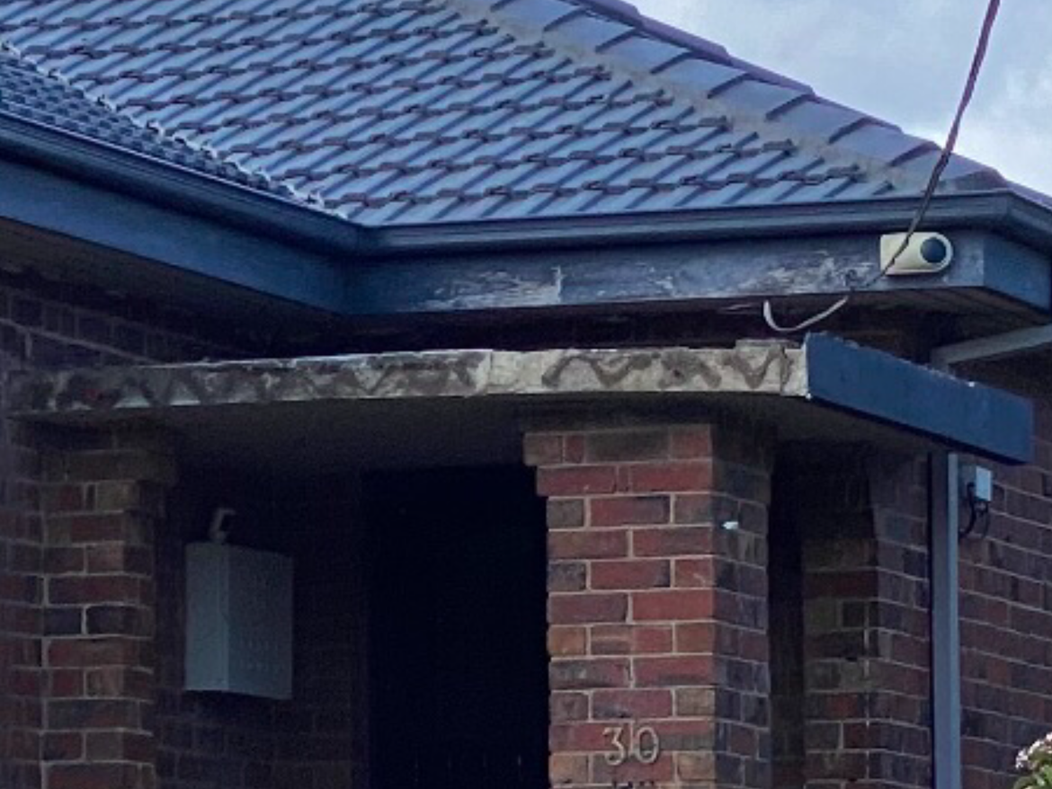

The other cladding that remains appears to have a thin dress layer like a ply that looks like it’s been damaged also.

I’m thinking maybe marine ply, glued and screwed, over the top of the remaining cladding, and the same for the face.
Then rendered.
What are your thoughts please Jacob?
Hi @luckyphilh2os,
Unfortunately, because marine ply will expand and contract with weather, it is not a suitable substrate for render. You would find over time that because the timber "breathes" the render will crack and fail.
If the surface beneath is concrete, I don't see a need to add an additional layer over the top. You could just remove the cladding from the other side, clean up the surface as best you can and render straight on to the concrete beneath. This would be a cheaper and more effective method of rendering the surface.

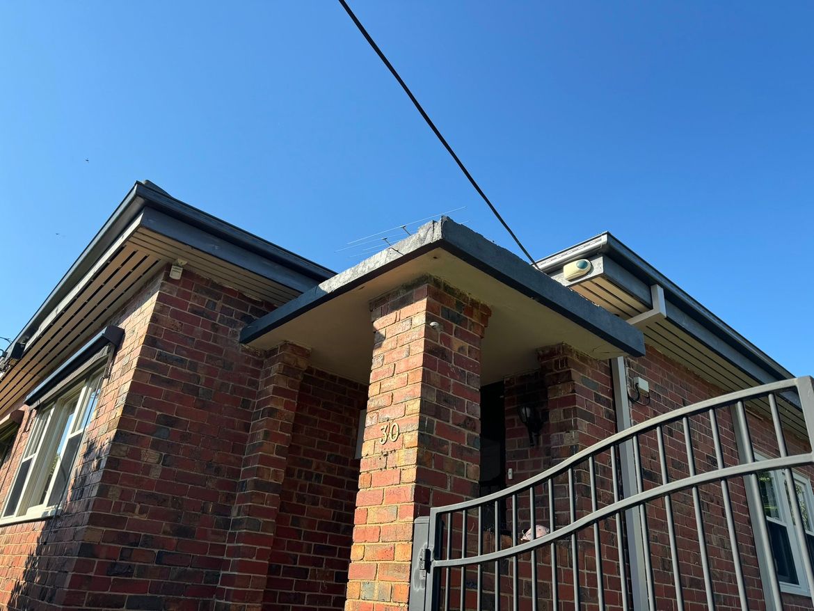

On closer inspection, the front entrance entire roof structure above the brick pillars should be replaced.
Its all still solid enough, but the rendered polystyrene surround was icing, hiding structural issues that need attention.

i won’t be standing on that rhs overhang anytime soon, but the
main structure is solid.
