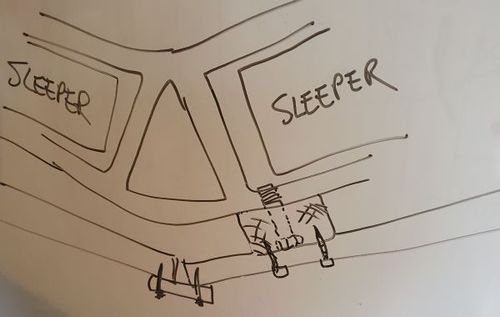

It's great that you've received excellent advice from @Dave-1. I was thinking about Dave-1's explanation of creating a large hook that would go over the sleeper. It can be done with the 70x35, and I propose using Selleys 350g Liquid Nails Heavy Duty to glue the frame to the concrete sleepers. I've drawn a sample image below to give you an idea of what Dave-1 I believe is proposing.
Please have a good look and let us know if it this design is acceptable to you.
If you wish to modify the setup, please let us know.

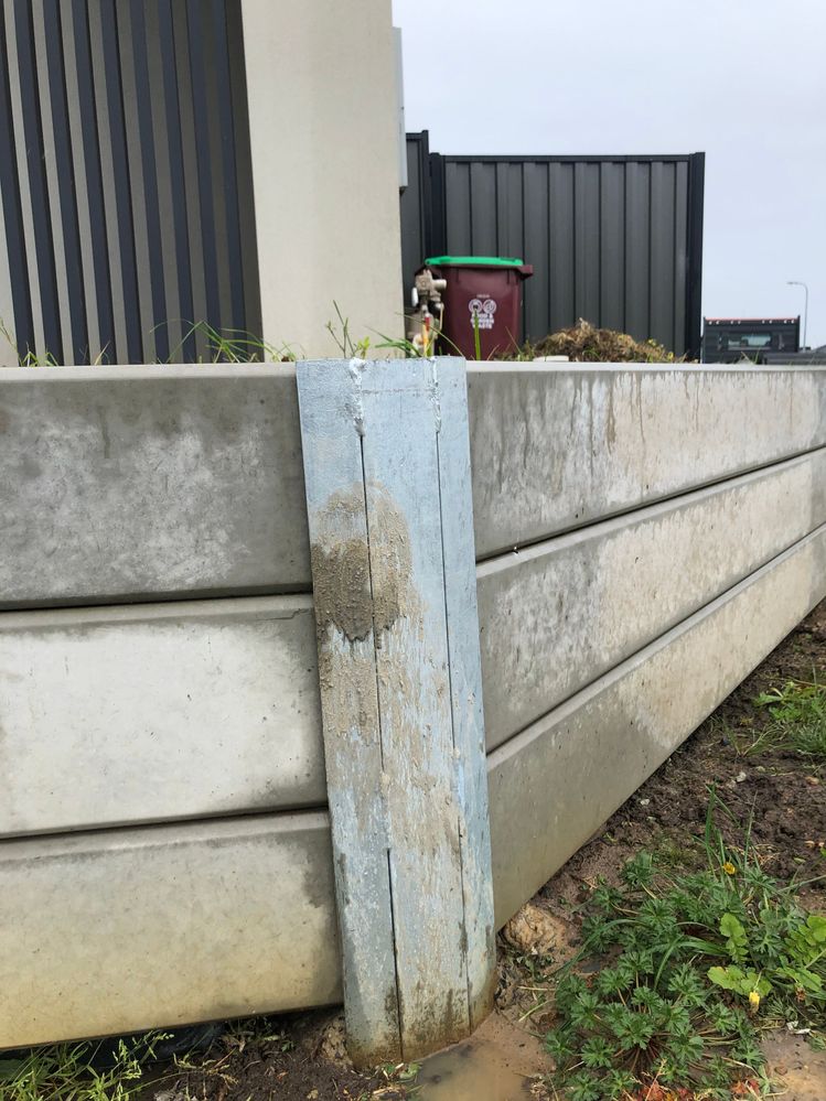

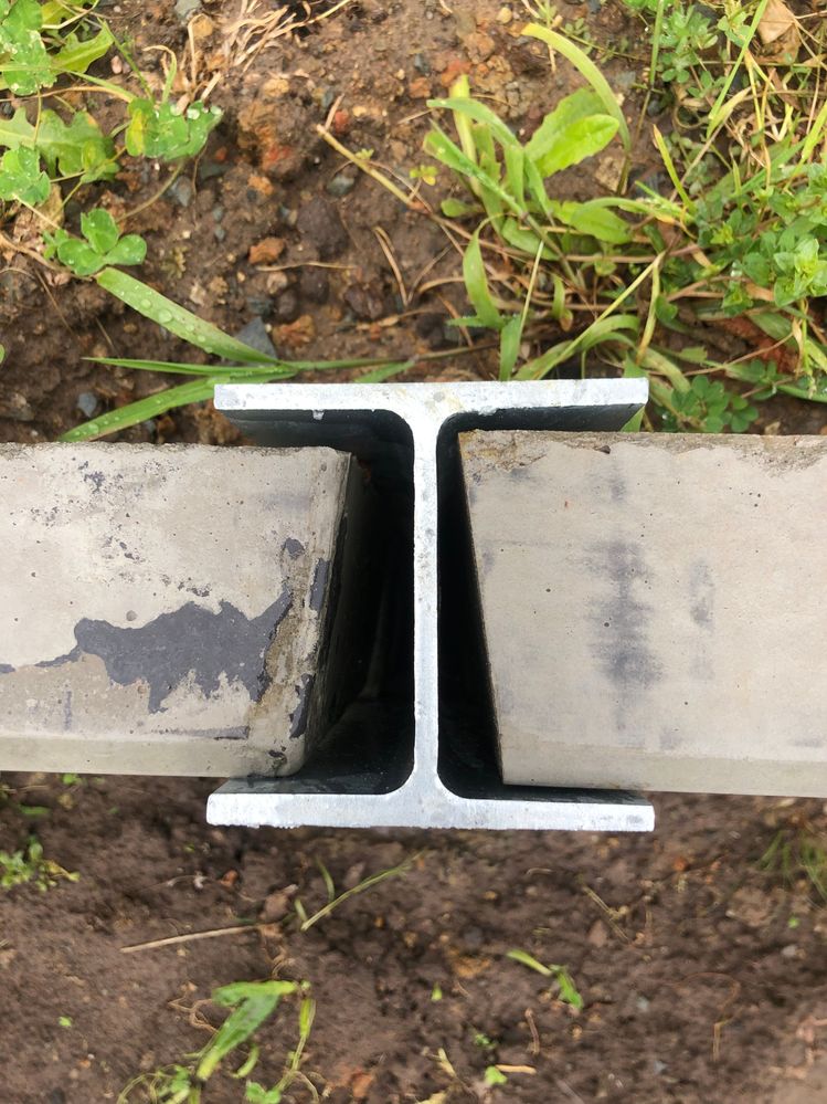

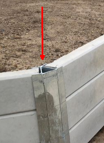

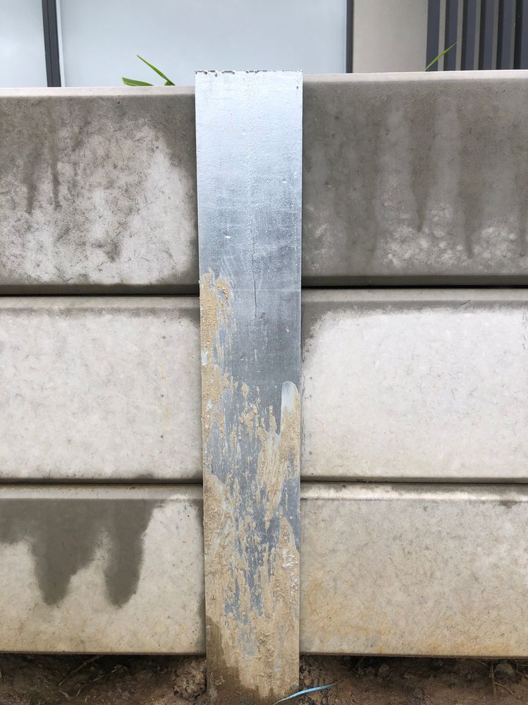

Any chance of some close-up photos, looking down on the retaining posts - just to see what gaps there are and what dimensions are available?
I was thinking along the line of drilling - then tapping threads for bolts...
You wouldn't need much.
Cheers.
Afternoon @DIYHome
Mmmmm First up I hesitate drilling into the gal posts, there is no room to screw bolt anything between the steel and the concrete and I dont trust the sleeper to not fracture as you try and drill through it. They look like a very tight fit.
I would still go for the "Hook" option over the concrete and then have your 35*70mm timbers laid horizontal between the hooks, i would still suggest 3 hooks over the 2m. You could then attach your eco deck in vertical pieces. I dont think gluing would work to well.

Hi @Noyade more pics attached as requested and thank you for the reply
