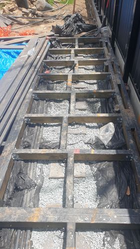

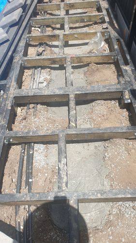

I am extending my deck and planning to build a long bench on top of it. The bench will weigh roughly 500kg by the time I build the frame using 90 x 45 h3 and then completing it using composite decking boards on the face. The bench will be 4.4m long. I would appreciate some guidance on the flooring frame please. The frame is roughly 6.4m x 1.2. I have supported the rims using stirrups every 1.2m. I have joined the joists to the rim by using two bugle screws (100mm) on each end. The joists are roughly 450mm apart. Is it sufficient to have joists joined using the bugle or is it better to also add joists hangers please to give the structure the strength to support 500+ kgs. The boards on the frame are temporary to walk easily. Many thanks

I have mixed cement with blue metal. I have then covered with weed mat and placed paver on top over some more blue metal. It feels sturdy now thanks for the guidance. Please find some pictures attached.
That looks excellent, @tejmankar. Your added effort will ensure the longevity of the project.

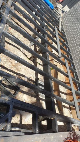

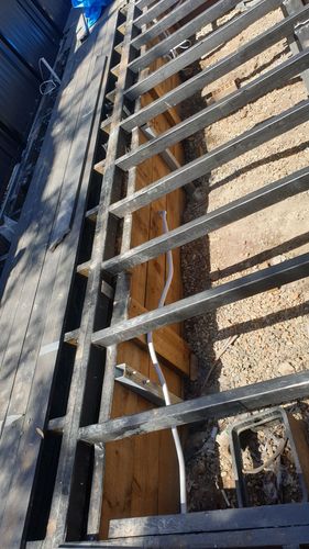

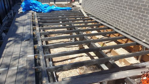

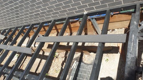

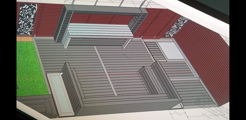

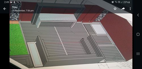

The work I have just done is to extend the existing deck. Please find attached the photos of the existing deck. The existing deck will also hold a bench in C shape and will be 3.2m long and 1.5m on the sides. Please find attached the design of the upgrade. My concern was to make sure that the deck can hold ~1000 kgs. as the bench it itself will weigh about 550kgs to 600kgs and the people sitting will add to it.. I wanted to make sure that the deck frame is very strong. Any thoughts? I have changed the design to move the bench on existing deck rather than what I just built (extension). The extension will now have the table in the new design and bench will move onto the existing deck. Looking forward to your comments.
That extra weight is being evenly distributed over the entire area @tejmankar. You don't need to worry about the weight of people. That's factored into standard deck construction. A deck can hold people and additional weight above what would be considered ordinary usage.
If you wanted to make the area really strong, you could add another two posts at the red stars for support and then run additional joists across, as previously mentioned. I don't see any point running additional joists unless you add the additional supports to the mid-bearer. That's the weak point.
