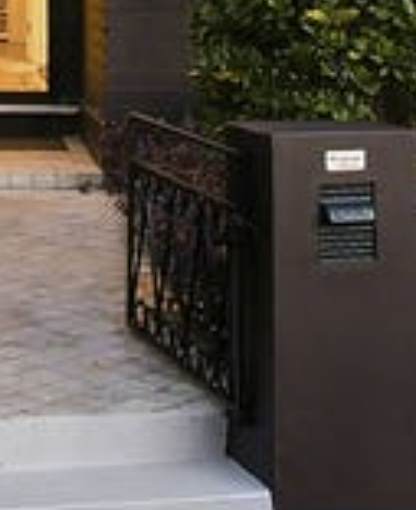

This is the best picture I have below. Do you think the zip ties will fit through the holes in the mesh of the shade cloth? I am not sure how tightly woven it is. And would you recommend I buy enough to cover the front and back, since it's a small gate? I could fold it over the top.
Hello @michaelmkchu
Thank you so much for the photo update. For a moment there, I was imagining that it was going to be a huge thick industrial gate that we would be tackling. To put your mind at ease, yes, you can fold it over the top if you wish. I imagine you are trying to keep something inside your garden and not let it out? The tip of the zip tie should be sufficient to punch through the shade cloth. I suggest doing the corners first so the shade cloth will be nice and tight. Then stretch it straight as you attach more zip ties to it.

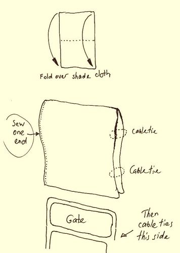

"I could fold it over the top."
That's how I see it Michael - making a sort of pillow case for the gate and a couple of strategically placed cable ties on the hinge side once it's in position. A roofing punch could 'spread' holes for the ties.
