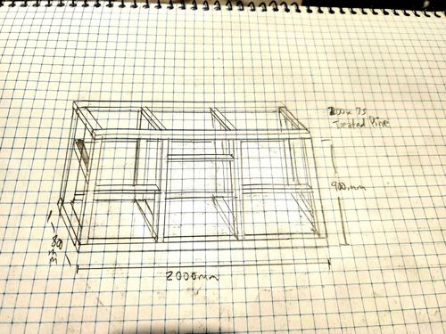

Thanks for that. I've tried to sketch out what I was thinking. It's basically a 3 dimensional mini stud wall. Using 75 x 200 treated pine. Cross bracing both front to back and horizontally left to right. It's a little hard to sketch it the way it is in my head.

That is a good sketch of the timber support. I suggest bringing your sketch to an engineer or builder and explaining to them what you plan to build and put on top of the timber frame. Since you have the length, width and height of the benchtop you're planning to build. The engineer and builder should be able to give you advice in regards to the timber base and the proper construction method for the concrete bench top.
