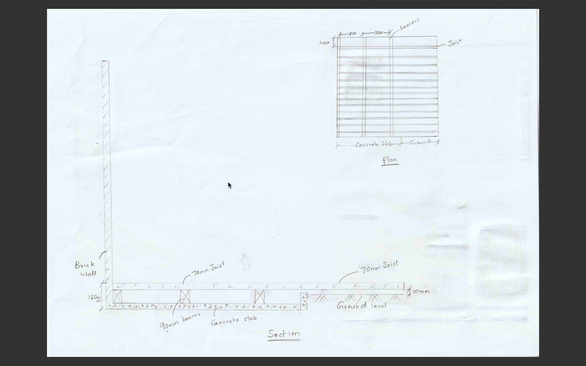

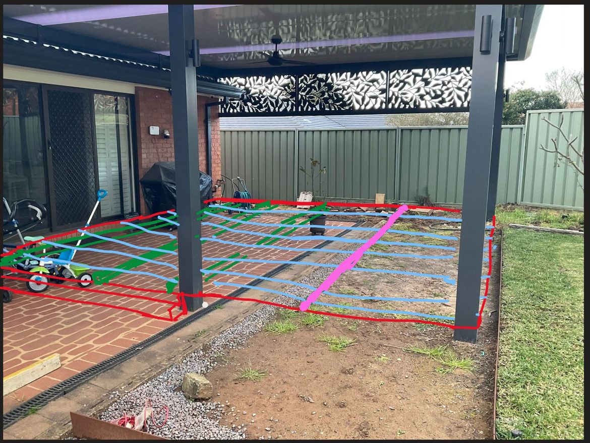

Hi All, I'm in the process of planning for a deck as shown in the photo below. I'm planning to use Ekodeck boards. As you can see in the photo, the deck partially sits on concrete slab and the remaining part sits on the ground. For the portion on concrete, i'm planning to use 90x45mm bears at 1.5m spacing (shown by green lines) and joists of 70mm at 450mm spacing (shown in blue). I need some advice on the framing on the ground as there is 100mm height to the deck level and there is no room for the bearers. Also need some information for footing in ground. I'm not sure If i have explained my question clearly. I have added a pencil sketch plan showing the levels for better understanding.
