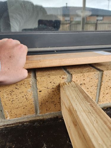

And one last one. The board that will run along the stacker door sill... This will be running along the brick sill (but about 20mm higher).
Hoe do I attach that board as the joists won't be running over the brick sill? Picture below might help explain what I mean.
Or do I have to run the joist over the brick but notch it out so part of the joist runs over the brick sill?

I'm sorry, but can you please explain further when you mentioned the triple joist? At this particular point of your planning stage, I suggest drawing up a decking frame plan so that you can address these type of assembly issues. The direction of your frame will dictate the direction of your deking panels. By finding out your panel direction you can then sort out the installation issue with the KlevaKlip 88mm Nylon ModWood Decking Concealed Fixing Clip.
I also suggest thinking about increasing the height of the decking frame so that it lines up with the panel that you'll be installing on the angled brick. Since there is no timber to anchor onto, I suggest cutting a timber wedge to go underneath the decking panel and you can anchor it onto the brick with masonry fixings. The tricky part is to line up the panel with your actual decking and have the correct gap at the same time.

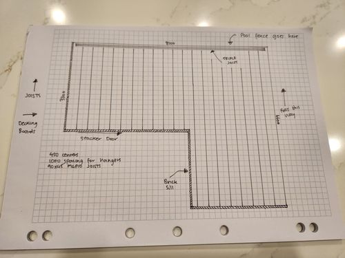

Hi Eric.
I've drawn the attached.. Hopefully it makes some sense.
The triple joists were requested by the pool fence installers to hold the pool glass and are at the lowest point of the deck (top of the below diagram).
My question is that because I am using the joist hangers, they work fine for a single joist but having 3 batten screwed to each other...those hangers won't work with 3 joists bolter next to each other. So I am wondering what other option I have for raising the triple joist to the right height.
Hi @Lockmc
Thank you very much for posting your deck framing plan. In regards to the triple joist that will be sandwiched together, I suggest using a nut and bolt assembly to bind them together. I also recommend putting them in a staggard pattern so that the hold on the timber will be spread out.
As for the footing, I recommend using Builders Edge 70 - 170mm Bigfoot Xl Pedestal Feet. However, if there is not enough space for the pedestal foot, I recommend using 100 x 100mm Post H4 Treated Pine Wet CCA 1.8m dug into the soil to provide proper footing.
