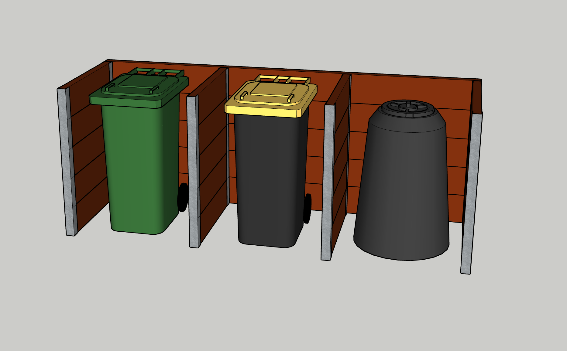

Is the idea to build an enclosure where you would, for example, have a wheelie bin for rubbish, a wheelie bin for recycling and then a compost bin?
You'll have to use materials that can withstand the outdoors, so treated timber or hardwood is a must. Sienna sleepers are an option that would stand up to the weathering and look relatively nice.
The sleepers could be joined and concreted in place using sleeper posts. You'd need two corner posts and six end posts.
Something along the lines of this.
I think this is good as a starting as it gives you a nice solid structure you can work off of.

Ive seen plenty of enclosures with lids that open, that open the bins themselves. But I like simple. The drawing that @JacobZ has done is almost what id be suggesting, tho another 1/5th higher. This is to stop wind blowing across the top and lifting the lid and then the bin "taking a drunken walk" It also somehow makes it look not so much like "thats a bin cover" as the shape looks a little different.
At the moment my bins are half hidden by the fence but on even a resonably breezy day that all stagger about. Three pavers are still not enough to hold the lid down. So higher sides would work in my situation. Waiting to see your photos :smile:

I like @JacobZ 's rendering above. 👍
