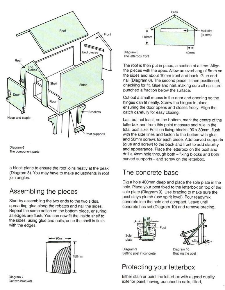

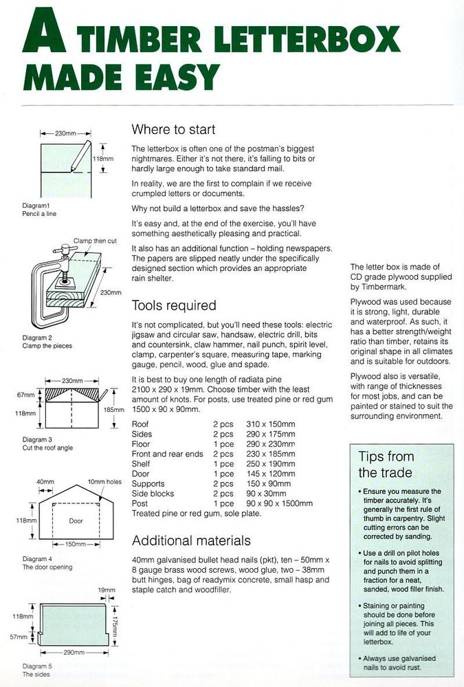

In the meantime.
Here's another mail-box set of plans...
