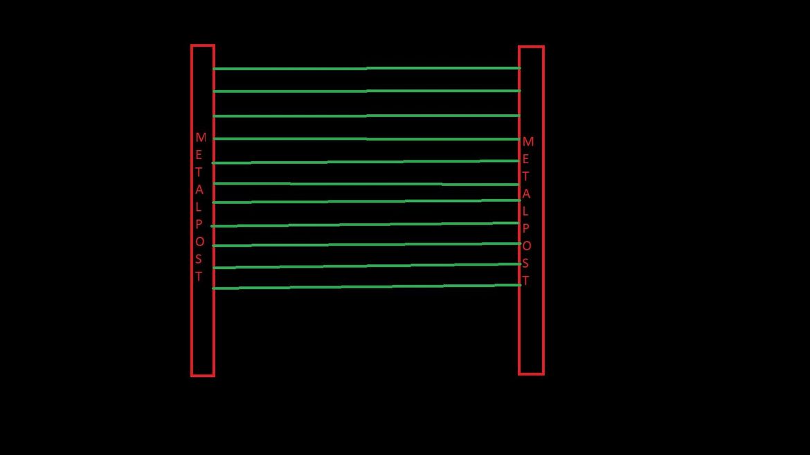

im planning on making a vertical garden,
on the photo below i was thinking of having steel post on each side, use cement as base foundation
then use some sort of cable suspension(green lines),
then have peg board or mesh grid placed on the wires
then small garden pot hooked onto the board or grid.
so the question is would the wires be able to support the weight?
any other suggestion to improve this as well please
also the length from post to post is around 4.6m apart
thank you in advance
Hi @kelso101,
By using turnbuckles you can pull wire exceptionally tight, so I would presume that your idea will work. However, I'd need to know more about the pegboard you were thinking of using and the overall weight of the pots and plants. I suspect there might be an easier way to go about this. Have you seen some inspirational pics that you'd like to achieve? If so, please post them, and I can outlay a simple way to replicate the project. You might like to check out @Karl1's Vertical herb garden on reinforcing mesh and @BrendanB's Vertical garden and Merau planter boxes.

Hello @kelso101
Verticle gardens have always caught my attention. I really like the idea of using maximum space.
Thats a fair span between posts and a lot of tension would be between them especiallly hanging a quantity of anything off the wires.
Would you change your thoughts on the disance of the span or maybe even using Builders concrete mesh between posts to support the hanging garden? That way you could loop the hooks over it and it would not sag. You would have to have some rails tho as it would want to flex.

Hi @kelso101,
I think the project Vertical herb garden on reinforcing mesh best illustrates what you are trying to achieve. As @Dave-1 mentioned, that is a fair distance between posts, and I think you should consider adding additional posts to minimise the span.
If you could reduce the overall distance to 3600mm, you'd only need one post in the middle and two outside posts. You could use two sections of Jack 1800 x 1050 x 5mm Light Duty Reo Mesh. I'd still recommend that you run a timber support at the top and bottom of the mesh that it can be secured to. This will prevent the weight of the plants from distorting the mesh. I've created the rendering below to ilustrate.

Afternoon @kelso101
I think it would depend on what type of posts you lay your hands on. My first thought was using fencing posts as they have the channel inside them ect?
For the size of the mesh id keep an eye out on what is around. Also if you want builders mesh (will look rusty) or Gal mesh which is coated and wont rust. I use Gal mesh for my gabion baskets when building walls and they have not rusted yet. The two steel posts with that width in them I think will cause issue slongterm (sagging of the middle and also the posts slowly tilting off verticle. Is there a reason you want only two posts? If you can only have two posts then the top rails and bottom rails I would make sure dont flex so somthing like an "L" shape with timber to stop the bending.

Hi @kelso101
I believe the wire mesh @MitchellMc mentioned would need to be screwed onto the post. Having had a look at your initial drawing, the wires would be ideal for plants to climb on, but if you use the Jack 30 x 14cm Concrete Grey Vertical Garden Pot there will be nothing for the bottom part of the planter to lean on and it will tip over.
However, using the wire mesh will give the garden pot something to lean on. You can test this at the store by getting one of the pots and hanging it on the Jack 1800 x 1050 x 5mm Light Duty Reo Mesh.
As for the posts, I recommend getting something strong like a 100 x 100mm 3.0m H4 Treated Pine Post. It will be able to hold a large number of pots and can support the wire mesh at the same time.
