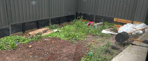

I was trying to find some answers then i ran into this post.
My fence is constructed on top of a retaining wall. Image attached. Can i use the sleepers as retaining wall?
i am intending to fill our backyard but worried that the sleepers are not enough. Can anyone give their thoughts on this?

Sleepers are the default material to use when making a basic retaining wall. They are made to hold back soil from a higher point in your property. A typical sleeper is 200mm x 50mm x 2400mm, supporting posts are placed in the ground to hold the sleeper in place. I suggest having a look at this guide - How To Build Retaining Wall to give you a better idea of how they are constructed.
Placing soil in front of the retaining wall is not going to compromise its stability. However, if the soil is very deep, I suggest thinking about installing drainage to prevent waterlogging to occur near the retaining wall.

Love retaining walls I must admit
Yours look solid and as @EricL states drainage is about the only thing to consider if you are back filling. So yes I would say you can.
A few questions to start with ![]()
How high are you thinking of raising the soil?
And with what type of material?
Last question is do you know where you storm water pipes are or you have free drainage away from properties?
And another question as I look at the photo, do you know what is on the other side of that retaining wall made of sleepers?
For drainage I would fill the area with soil and level it, then would go back and dig a trench and place a socked ag pipe in it ( Vinidex 100mm x 20m Socked Slotted Draincoil ) Now the one I have chosen is 100mm, I prefer the larger socked version as it wont clag up for awhile ![]()
As long as you have the end of the pipe exiting somewhere then it will drain the area, if you are unsure of where to place it, maybe along the fence line about a foot in? Depends on your landscaping. If you notice areas that pool with water now when it rains, then that would be a good place to start the pipe.
