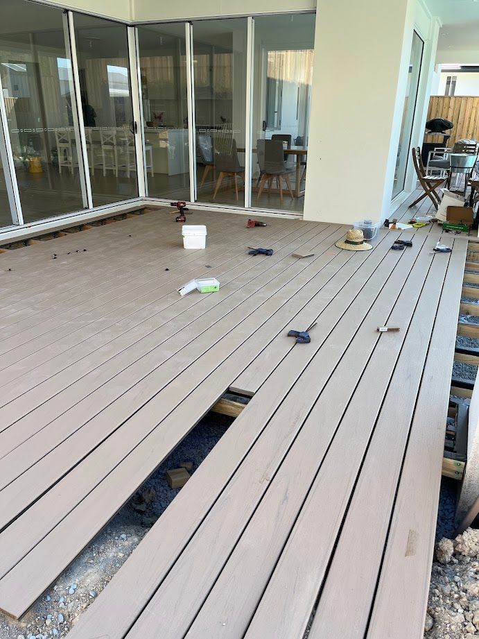

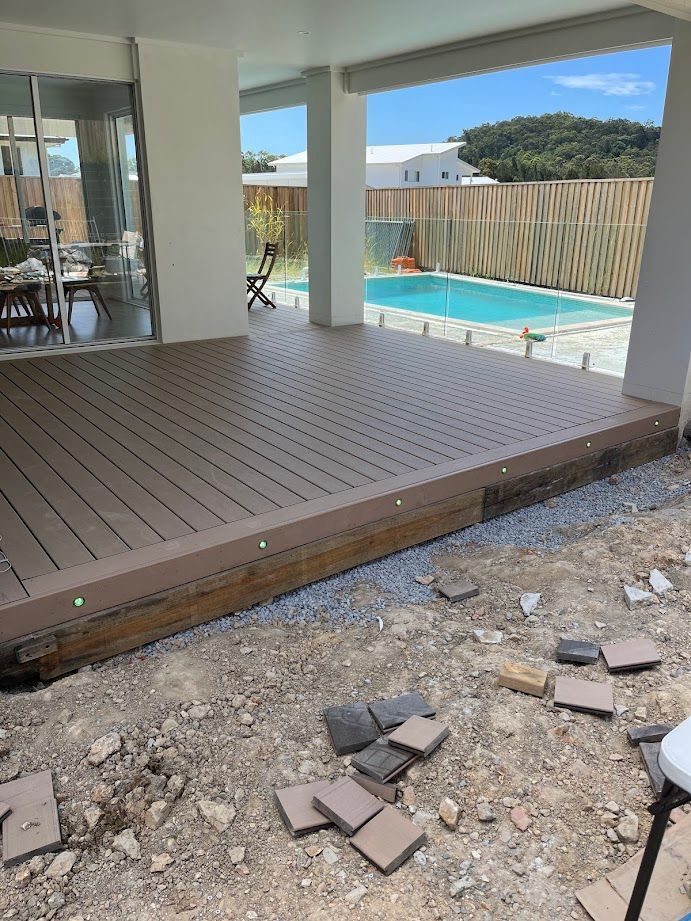

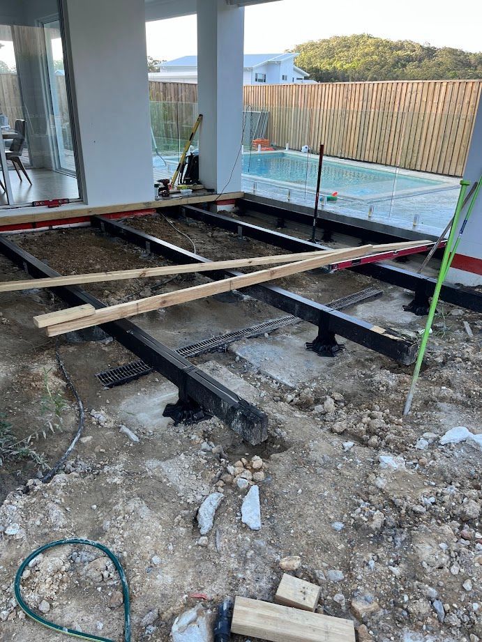

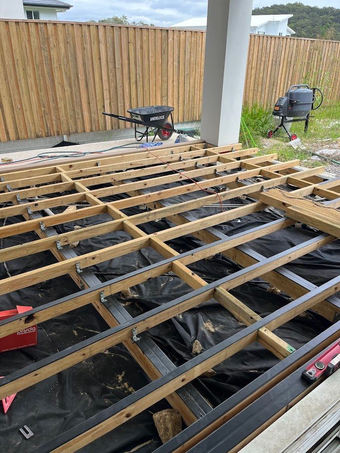

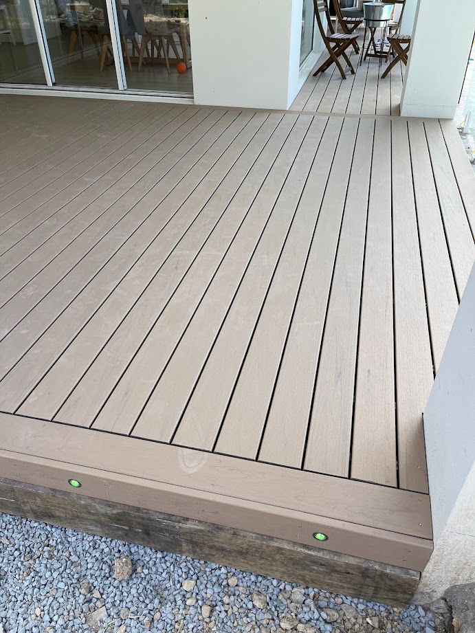

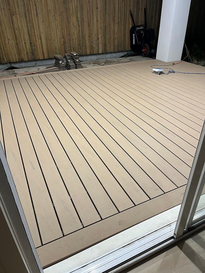

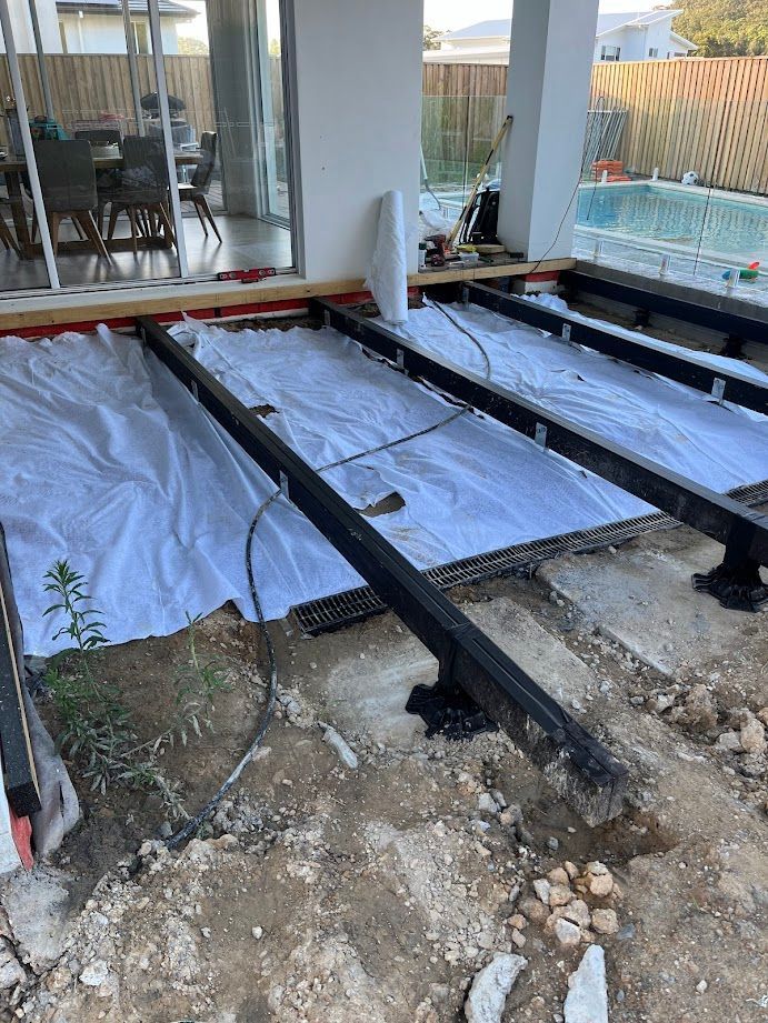

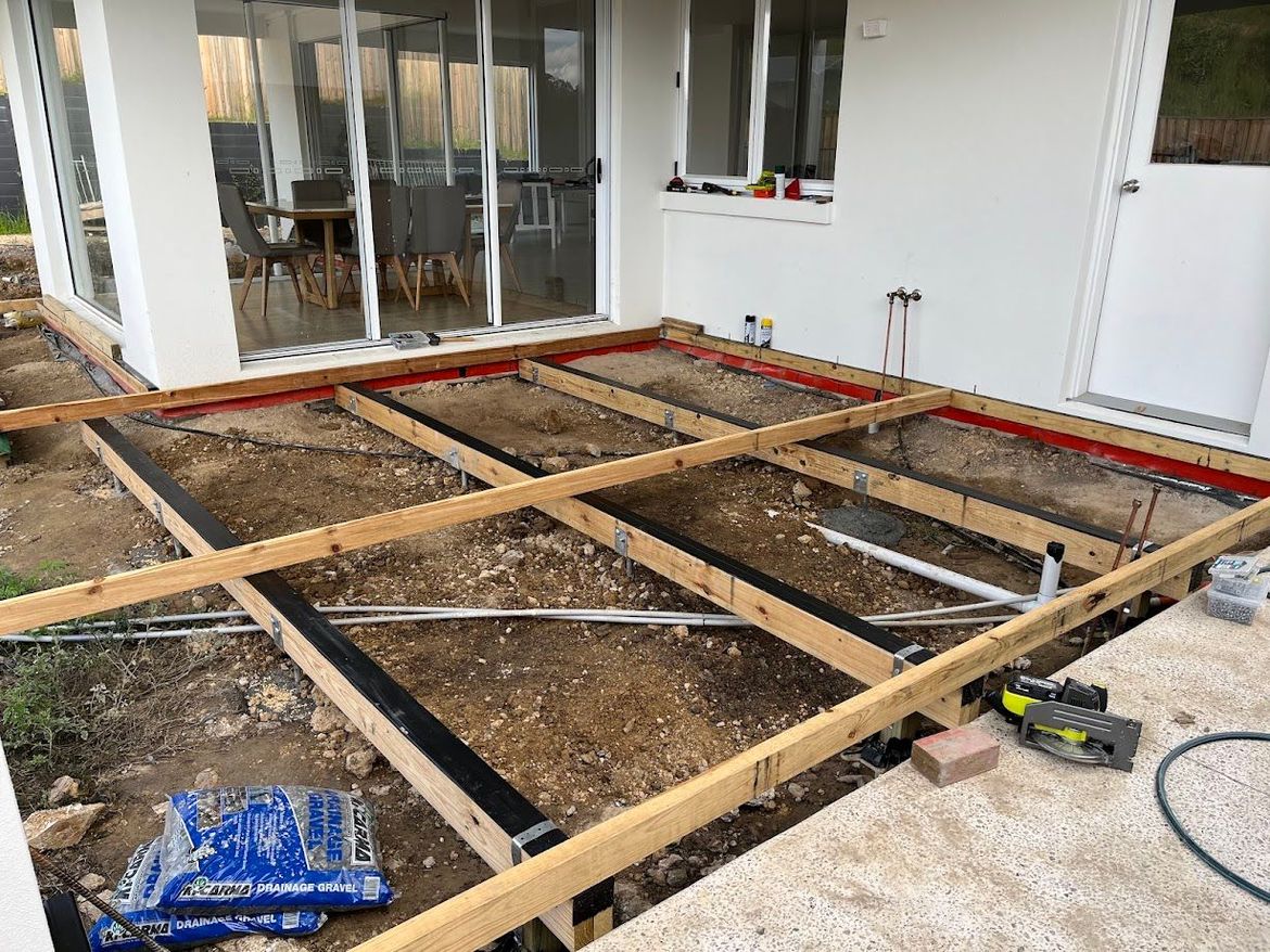

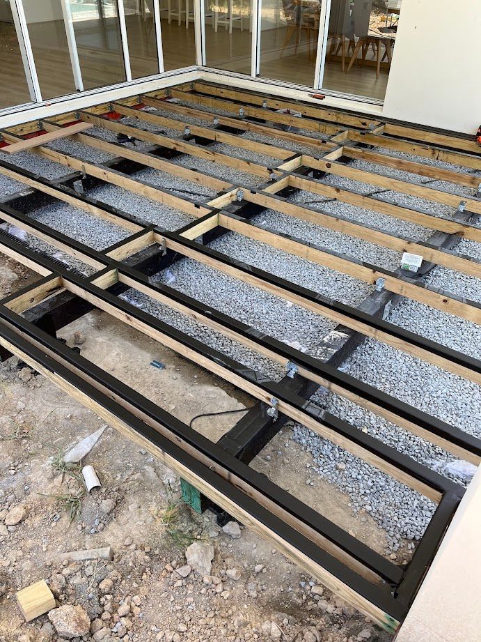

@MitchellMc, first of all, thanks for your help. I finished building the deck and I thought it would be a good idea to share the result here. It is a lot of work but I am happy with the outcome. Thanks again. I hope this brings a bit of motivation for those out there thinking about building their own deck.
