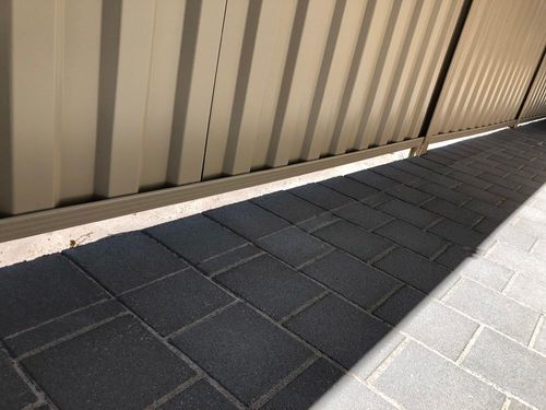

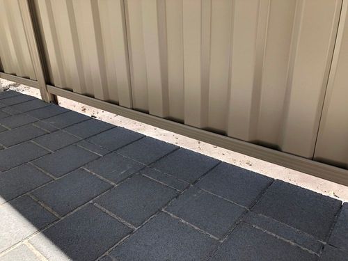

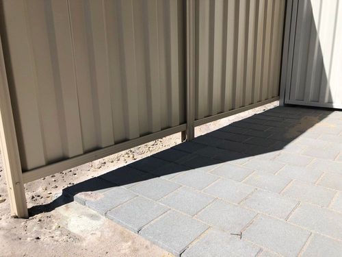

Please see pictures. I have these gaps, which are not even, throughout my fence in all directions. Any DIY ideas will be appreciated.

I have seen a few of our members take timber planks and place them underneath their Colorbond fences to close the gap as one solution. To add a little more interest, you could always build a small garden bed in front and plant creepers to give it a bit more interest, similar to @leighq's project that was inspired by @royq's climbers to dress up a Colorbond fence or @BrendanB's Vertical garden and Merbau planter boxes. If this is of interest, our resident DIY guru @MitchellMc will be back online in a couple of days and can give advice on how to create something like this. Let me also tag highly inspiration members @prettyliving, @sandy_d and @lifestylebymari to see if they have any additional ideas.

Thanks Katie! Those are interesting ideas. I may have to mix and match some ideas given the fence gaps are 72m long in total 😁
72m worth is quite extensive. What about using some 90 x 19mm or 140 x 19mm L/M Decking Merbau SpecRite Pre Oiled KD Select. You could screw straight through the face of the decking into the fence posts and bottom rail. That would both hide the gap and looks quite attractive.

Thanks Mitchell! Great idea. Woll go to Bunnings today and have a look at what I can do.
