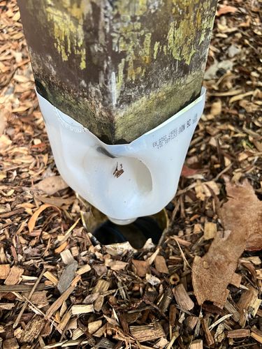

Hello, I’m looking for suggestions for how to connect a rectangular drain down pipe (150mm x 85mm) to a round (85mm dia.) in ground pipe.  The gap between the pipes is approx 100 to 150mm and the end of the in ground pipe has been broken off hence the jagged edge.
The plastic milk bottle does a good job to direct the flow to the middle of the pipe but there must be a more elegant solution!
Thanks for any advice.

Probably another illusion - but the descending portion looks square to me and you've used a 2 litre milk bottle?
One of those sides is 6 inches?
I was thinking of digging around and exposing the PVC pipe - at least that way we can repair/replace/alter that section.
I like taking photos of plumbing problems and then head down to plumbing suppliers, like Tradelink, as they always come up with solutions and I've found there's always an inquisitive plumber at the counter that likes to pitch in with advice.
There was a clever gent somewhere on this site who used a heat gun to mould a PVC pipe to fit an irregular shape. I'm wondering if 6" PVC pipe could be shrunk to fit and then with reducers eventually match your 85 mm PVC outlet (which needs to be replaced)?

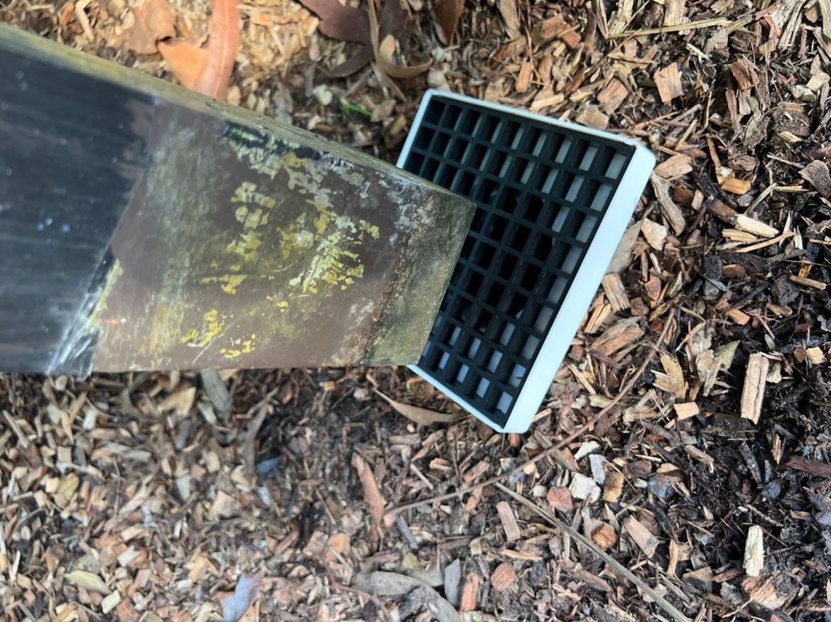

Have you considered installing a stormwater pit there, so the water falls into the larger opening? Or, do you want a closed connection?

Thanks @Noyade and @MitchellMc, great suggestions and you’re right, the down pipe width is 105mm wide not 150mm. I’ll dig out around the in ground pipe to see if the adaptor option will work. Thanks again.

Thanks for the suggestions, after a bit of digging the storm water pit seemed to be the best option and I’m happy with the result. Thanks again.32C7ED81-D45D-4D6F-90C5-74186E017D88.jpeg
Re: How to connect rectangular down pipe with circular in ground pipe??
Great solution @dmdwhite. That looks like it will certainly do the job.
Many thanks for sharing your results.
