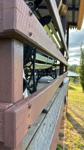

Hi All,
I am removing my old balcony railing in order to sand and repaint it. The hex screws you can see in the photo currently sit proud of the wooden railing face, and I'd like to have them in set so that the top of the hex screw is level with the wooden railing. Is this still called countersunk? I think countersinks have an angled blade, but this one will need to be flat to sit flush against the back of the hex head. Do you have these and what are they called, please?
Thanks,

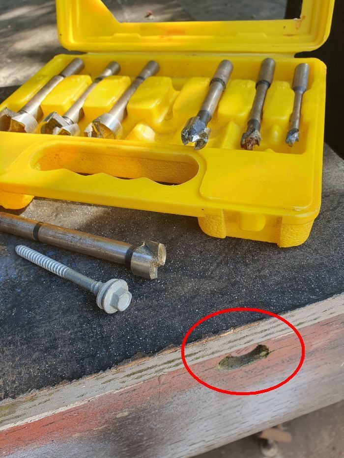

I'd go for a set of Forstner bits.
A quick measurement of my hex head is 15 mm - so my 5/8" would suffice. I'm sure they also come in metric.
You can see (circled) a larger Forstner hole I made for bolt heads. I tend to make the Forstner hole before you drill for the bolt or screw.
Low speed drilling - but usually, I use a Bit and Brace - call me old-fashioned.

Just a friendly reminder to measure the height of the hex-screw head to make sure you don't drill too deep into your timber railing. Please remember to wear appropriate safety gear such as gloves, safety goggles and a dust mask when drilling into the timber.
