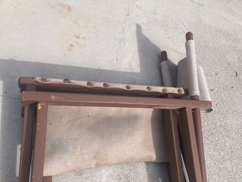

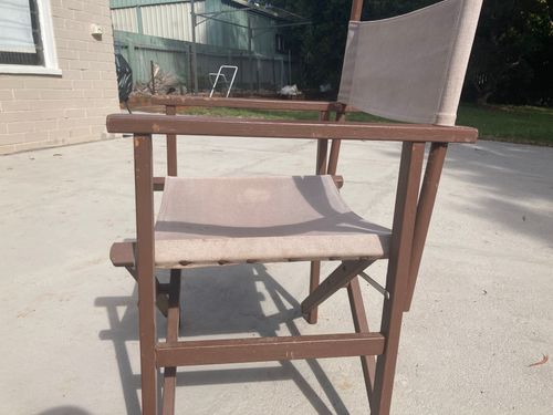

Unfortunately, my chairs had fabric that was attached on either side simply with furniture tacks (I'm not sure of the correct name for these but they are similar to thumb tacks and pushed through fabric into wood)
Current director chairs all appear to be slightly different in that they are built with a groove in each side post and the fabric is looped on the edges and has a wood rod which slips in and then appears to be slotted into the groove on each side.
I have only been able to obtain seat fabric suitable for the modern chairs.
That's o.k. save that I will still have to fasten it to the chair side rails and can't use the rod and pocket type of fastening.
I can simply fasten them again with furniture tacks.
I don't want to do that if I can avoid it because I'd like to be able to take the fabric on and off easily so that I can wash it when necessary. Undoing tacks is a pain as there are 6 on each side rail and it is also difficult to get them on and off repeatedly without damaging the side rails.
So, I wonder, does anyone know of a way I might be able to secure the fabric onto the side rails with some sort of clamping piece or gadget so that I can fasten the seats on and take them off quickly and easily and without damaging the wooden side rails or the fabric?
I've attached some photos and hope that these show what I mean ...

If your seat is constructed in the same manner, the back rest assembly can be duplicated with heavy duty stitching. It can then simply slide into place without the necessity of using furniture tacks to hold it in place.
As for the seat, I propose thinking about a sandwich system where the fabric is held in place between two pieces of timber. I suggest placing the fabric over the seat frame and then putting another timber piece such as the Porta 20 x 8mm 2.4m Bullnose Cover Strap Tasmanian Oak over the fabric and fixing it place with Zenith 8G x 30mm Galvanised Button Head Stitching Timber Screws.
You'll still need to use a screwdriver, but it will be easier to re-assemble it using the screws rather than upholstery tacks. My best advice is to drill pilot holes for the screws to prevent splitting the timber frame.

I am kind of thinking along the lines of @EricL's suggestion but slightly different. Lets see if I can describe what I have in mind.
Current piece of material is enough to dip over the seat and half over a rail that is then tacked down on the underside of the piece of timber.
Potetential fix - Imagine that that material is a little longer in width to enable it to wrap around another piece of timber and then thumbtacked down to it. This new piece is attached to the underside of the existing piece of the seat strut with two butterfly type bolts so you can disconnect it from the seat structure either side. So top photo where the tacks are the material continues and then is tacked to this seperate piece of timber (material ends up between the two pieces (base of seat plus new piece) the wrapped over as the tacks are in the same position as the old location.
Potential fix num 2 - As above however instead of the material being tacked onto the timber you allow enough material to effectivly do what the back rest does around a piece of timber and stitched so it can slide off when washed and then using the butterfly bolts through the two pieces of timber (existing and new piece) you can secure it to the chair for normal operation..
Potential fix num 3 - Same as num 2 but instead of a sleave around each piece of wood on the sides you could make the seat material a big loop, think pillow case where you put your arms in it and stretch it out as far as you can, your arms are the two new pieces of timber and they are attached to the underside of where the tacks are now (inside the new loop of seat you have stitched). You will have to do some pretty solid style stitching to make sure the weight of the person in the seat dosnt pull the overlap join apart is all.

Thanks very much for your suggestion. I'll give it some thought but it sounds to be the sort of solution that would work for me. The back is no problem as I can use the pre-made fabric and just slide it on. The fabric for the seat, though, also has sewn channels which, of course, I can't use because I don't have an open end on the side rails to allow sliding on the seat. However, I intend to unpick the seam of he looped edges of the fabric to give me extra width which I can wrap around the side rails or, as you suggest, another piece of wood.
