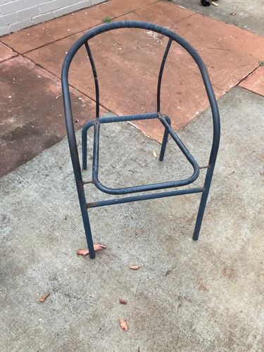

I have a couple of outdoor garden chair frames that were originally covered with woven 'plastic' of some sort. Over the years it fell apart.
I hate waste and so recycle what I can. The metal chair frames are o.k. save for needing a little rust removed and a repaint. So I want to cover them to make them usable again.
My thoughts have been to use webbing in vertical and horizontal interwoven lengths effectively giving a checkerboard seat and back on the frames. This is my preference but I'm unsure as to how I would be able to fasten each end of the webbing strips together so that they are effectively just 'loops' stretched over the frame - or, alternatively, whether I ought to drill and screw into the frames - an option I don't particularly want to use.
I wonder if there are any sorts of fasteners that could join two webbing ends together securely and with enough strength to hold firmly with the weight of someone sitting on the webbing once fully installed?

Would you happen to have a picture of the webbing strips you'll be using? I'm just curious to know what kind of material it is. Is it weatherproof or is it just ordinary thick fabric? Using a timber panel is definitely an option as you can attach it to the steel frame with steel saddles. This will save you from having to drill into the steel frame. You'll also have the option of either leaving the timber as is and just painting it with polyurethane or upholstering it.

Thanks for the additional information regarding the webbing. I suggest having a look at using Grunt 50mm x 25m Jute Webbing. It has a breaking strength of 180kg, which means that it can easily hold an adult person's weight.
I propose doing a traditional weave of the jute webbing around the tube frame going below and above each other. I suggest anchoring the start with some heavy duty sewing to allow you to weave the jute webbing tightly. I've placed a sample image below to give you an idea of how you could weave the jute webbing. When you reach the end of the weave, I recommend anchoring it with more sewing using very thick thread.

It looks to be a steel tube chair - so I do think it is a good option. The photo below is an aluminium chair from 1958 - you can see the bolts supporting wooden slats via lengths of thin plate steel. It certainly has withstood time and the weight of countless bodies over the decades.
An option for you?
You're on the money, as usual, @Noyade. The product that @EricL was referring to for @nonsibicunctis's project are steel pipe saddles.
