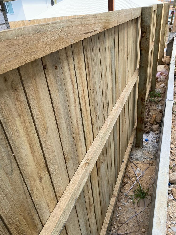

I'm looking for some advice on best and cheapest way to cover the gap (about width 36 cm) between my neighbour's fence and our retaining wall (about 80 cm deep) over a length of 20 meters

I propose putting an extra rail on the fence and installing timber noggins across between the rail and the retaining wall. I then suggest putting Merbau decking panels on the noggins thereby covering the gap. I've placed a sample image below to give you an idea of how it can be done. The materials I've mentioned are designed to be used outdoors and if maintained properly will provide a long service life.

hahahah @EricL has beaten me to the punch! Here I was think you I would cover the area between fence and retaing wall with timber and then before I had figured a way to do it I scroll and @EricL has nailed it!
I would add that you may want to add a screen to the top of your fence as the new area will be large enough to stand on. Then easily lean too far over the fence and away you go....
Hi @sumeeth as much as I love @EricL plan I am not a fan of fixing any structures to neighbouring fences as long term its likely to come back and bite me.
So as a thought, you could could planter boxes out of 150mm x 25mm treated pine plinth board fixed to the inside of the concrete wall and also supported on galvanised stayed brackets. Drill holes in the bottom for water to escape, then line the inside of the boxes with builders plastic. You could plant them out with sometime of ground cover that flowed over the wall.

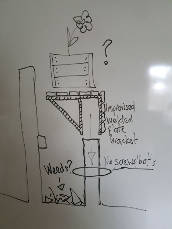

G'day @sumeeth
"(about width 36 cm)"
Not a lotta wriggle room there and I can't see much of what's happening on the right - but I was thinking of custom built brackets that slide down the retaining wall.
No drilling.
No screws/bolts
And they can be built in sections and easily removed if you need to access that cavity - dropped keys, weeds, etc.
Using that Merbau stuff or whatever - remembering we need 20 metres.
But having said that - MikeNZ's comments have been seared in my brain since this thread...
Should we - can we, hang things from retaining walls?
Just a question, nothing more.
